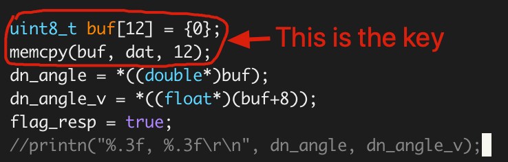

2021-03-24 5:17 AM
Thank you! I have solved this problem by making a buffer.
But I still don't understand why.
'dat' is given by other progress. I'v printed and checked the content is right. But I'll get hardfault.
'buf' is copied from 'dat'. And it works fine.
2021-03-24 6:52 AM
Copying one uint8_t array to another array of the same type will not solve anything. You will have to learn about alignment and unions. :) But you can start with an example from there:
