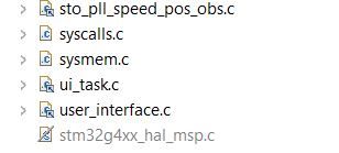

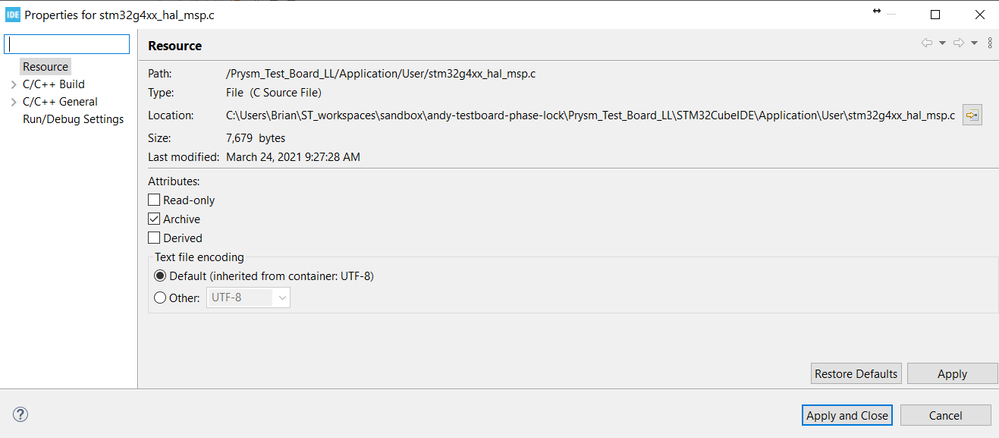

I did a drag & drop into the ..\Application\User folder where the other project C files are shown . The new file stm32g4xx_hal_msp.c still shows up with a line across the icon. If I add an intentional error in the file it compiles the project with 0 errors. If I click on the file properties I get what is shown below:
This is how it shows up in the ..\Application\User folder, it is greyed out:

I received an answer from my ST Apps Engineer, Nicolas Fillon, He suggested the file was excluded from the build and asked me to check under "properties->C/C++ build" and he was correct it was excluded.
I found some strange behavior with the "Exclude" button getting checked, as described below:
Oh! That's very interesting! I created a new file new_test.c by using "Add" new source. I then did a build with that file with nothing in it but C comments then adding some code garbage to create a build error. When I did this the project did get a build error. I verified the "Exclude from build" was NOT checked (I had not touched this). Next, I copied and pasted the contents of stm32g4xx_hal_msp.c into that file and renamed it stm32g4xx_hal_msp.c. When I renamed it the "Exclude from build" was now checked. Following your advice, I unchecked it and it now builds.
Also, I am now at V1.50.
My root problem was I did not verify the setting of "Exclude from build" and that option seems to be checked or not checked arbitrarily. Adding a file by either "import" or "drag & drop" should have worked if I then verified the "Exclude" button.
