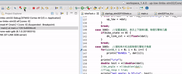

But on stm32f103rct6. It will stuck when I run this:
double test = *((double*)dat);
But use float will not stuck:
float test = *((float*)dat);
So, how can I convert memery to double rightly on stm32f103? (I use stm32cubeide)

2021-03-22 11:25 PM
How do you know it sticks exactly on that line which performs the conversion?
What does "stuck"exactly mean? Hardfault?
Single-step in debugger disasm view and note which instruction causes it to go to hardfault if that was the case.

2021-03-23 12:01 AM
It is a hardfault.
2021-03-23 2:16 PM
Single step in disassembler view, to view which instruction caused the hardfault and what was the content of registers at that moment.
A wild guess, compiler used LDRD wich requires that the array be 64-bit aligned.
2021-03-24 4:41 AM
As Jan said, most likely the problem is the lack of proper alignment. That can be solved by making a buffer to be of a double type. Or even better by implementing a union, which forces the alignment to the largest element and also seamlessly converts the data.
