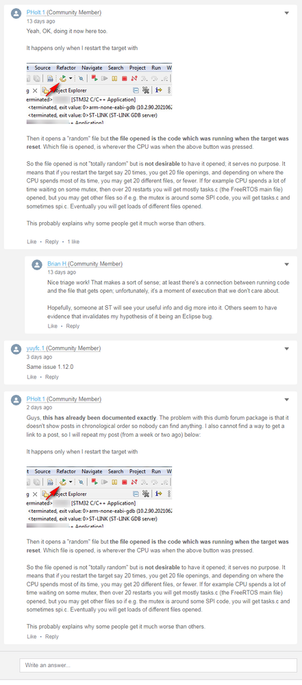

Oh, it's an old thread, but to make it perfectly clear, it doesn't halt like on breakpoint. It just opens the file, the debug session goes on. Without a debug session, when just `Run` option is used - it's the same. The app starts normally, but some files (usually startup / boot code) is opened. For STM32H7 project it's usually the startup file (so it's not random - it's really the first thing that is executed), then some system drivers and OS files, like usb drivers, diskio, that sort of thing. It's almost never the user code, however, it happened too - my application file was opened without a reason once or two.
So I'd take strong educated guess, that the file open is never unrelated to the project, it's always a file whose content was executed.
The problem is following: why does it open? When there is a breakpoint in a file AND when I'm in the `Debug` mode - it SHOULD open. Then and ONLY then. Here both conditions are false. There is no breakpoint in the startup file and I'm not in the debug mode. The file opens.
Another interesting detail: the spurious files are also opened on TERMINATING the debug session. I press stop, then a file opens. Let's say it takes a good hour from my work day just to close those files over and over again and then recalling what I was doing before and what was the file I was working on a while ago.

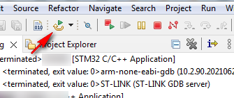

It happens only when I restart the target with
Then it opens a "random" file but the file opened is the code which was running when the target was reset. Which file is opened, is wherever the CPU was when the above button was pressed.
So the file opened is not "totally random" but is not desirable to have it opened; it serves no purpose. It means that if you restart the target say 20 times, you get 20 file openings, and depending on where the CPU spends most of its time, you may get 20 different files, or fewer. If for example CPU spends a lot of time waiting on some mutex, then over 20 restarts you will get mostly tasks.c (the FreeRTOS main file) opened, but you may get other files so if e.g. the mutex is around some SPI code, you will get tasks.c and sometimes spi.c. Eventually you will get loads of different files opened.
This probably explains why some people get it much worse than others.
