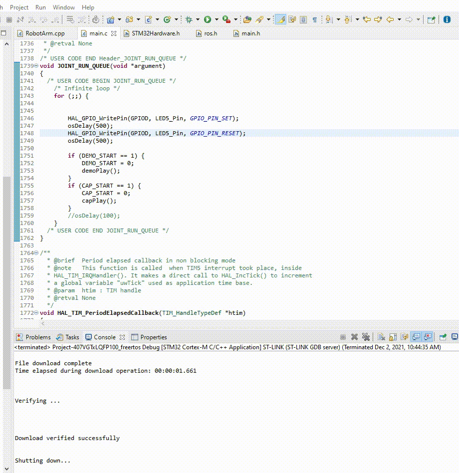

2021-12-02 12:48 AM
I faced the same problem! Interferes with work! Constantly, even when there are no errors, a random file from the project opens in the tab after clicking on "Run" (Run as).
