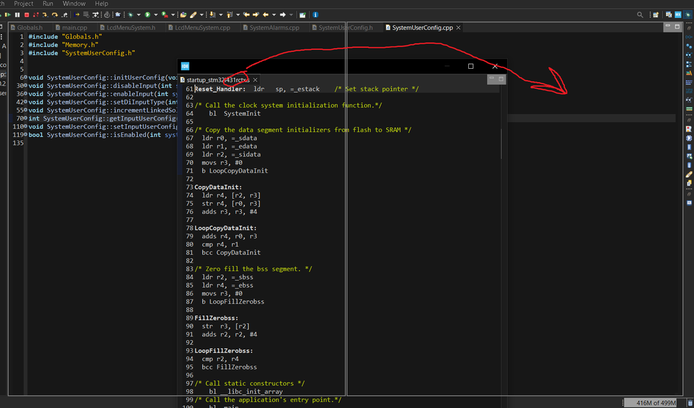

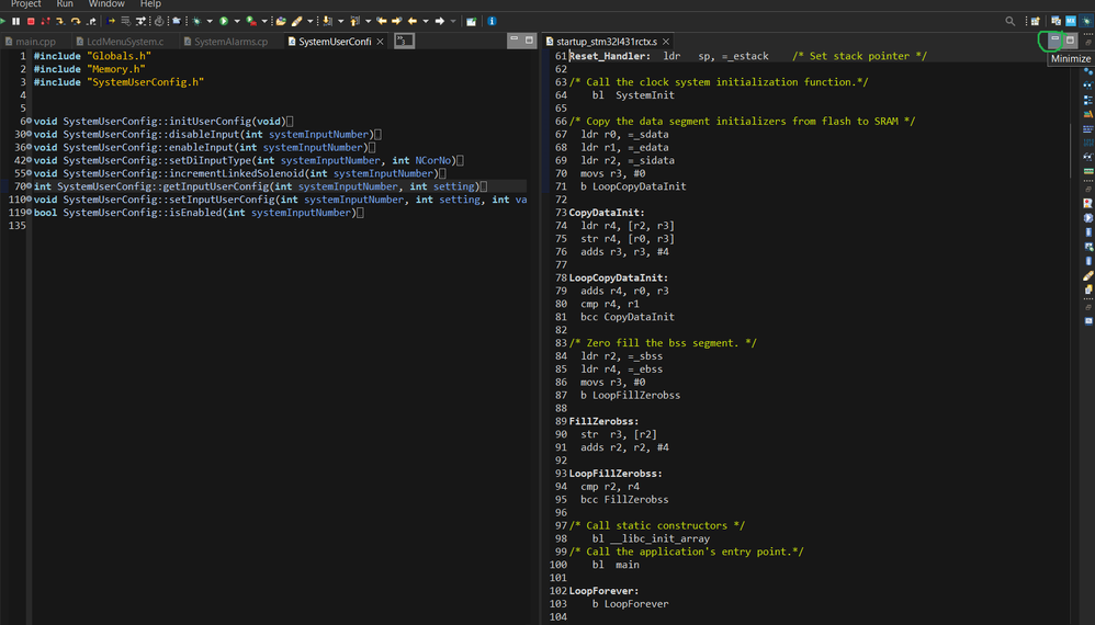

I finally have a work-around:
Open your editing perspective, click "Run" with you device connected of course. Right click and detach the random window that pops up. The click drag the window via the window tab circled in red and drag to the right side of the screen. When the gray separation line appears in the middle of the window as shown in the first picture, release click. Then minimize the window as shown in the second picture circled in green. Now, select "Debug", and change window perspective to debug. Repeat the same steps above in this debug perspective.
Now when either running/debugging your program, a small, minimized version of the startup_stmxxx file pops up briefly, but then re-minimizes once the run/debug initial startup is complete.

2023-03-20 1:25 AM
I tried to do that, but the minimized popup window does not disappear automatically (version 1.12.0). Thanks for the idea anyway.

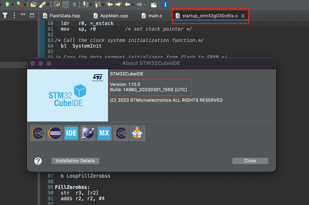

2023-04-15 8:15 PM
Same issue on 1.12.0
