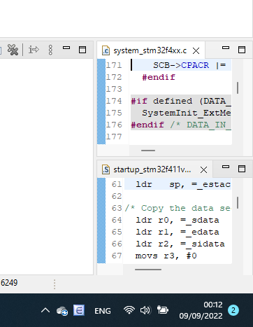

Hi, I also faced exact the same issue and I found this.
Detach and then drag those files to the bottom corner, and even hide it if you want.
Next time the cursor will remain in main.c file.

I can't replicate this.
I can Detach the file, but where is this "bottom corner"?
And do you have to do that with every file which pops up spuriously, and eventually you will have gone through all the .c files in the project?
2022-09-09 8:23 AM
A more simple way that I usually do is that detach and drag all of those files to my second screen. It will take you sometime at first, but after that the cursor won't randomly jump to another file.
2022-09-09 8:26 AM
Sadly say that you have to do this with all of those files.
2022-09-09 8:29 AM
Sorry but I struggle to work out what your "second screen" is. It is almost like you are running Cube on a phone, which you obviously aren't.
I have the standard Cube install setup i.e. the project hierarchy down the left, the edit screen in the middle, and the screen for stuff like breakpoints on the right. On the bottom is a screen for stuff like Console.
So there is no obvious place for me to drag the Detached file to.
2022-09-09 8:38 AM
Sorry, I actually mean my second monitor.
