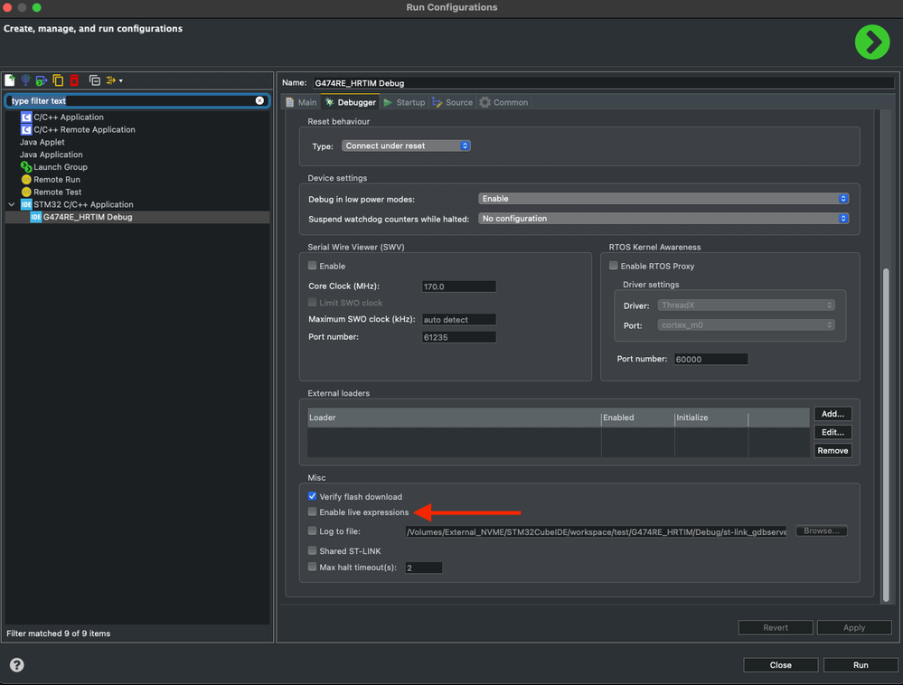

2025-04-02 5:21 AM
Same problem on OSX:
Version: 1.18.0
Build: 24413_20250227_1633 (UTC)
I can resolve this issue by disabling Live Expression in the Debugger settings (Misc).
