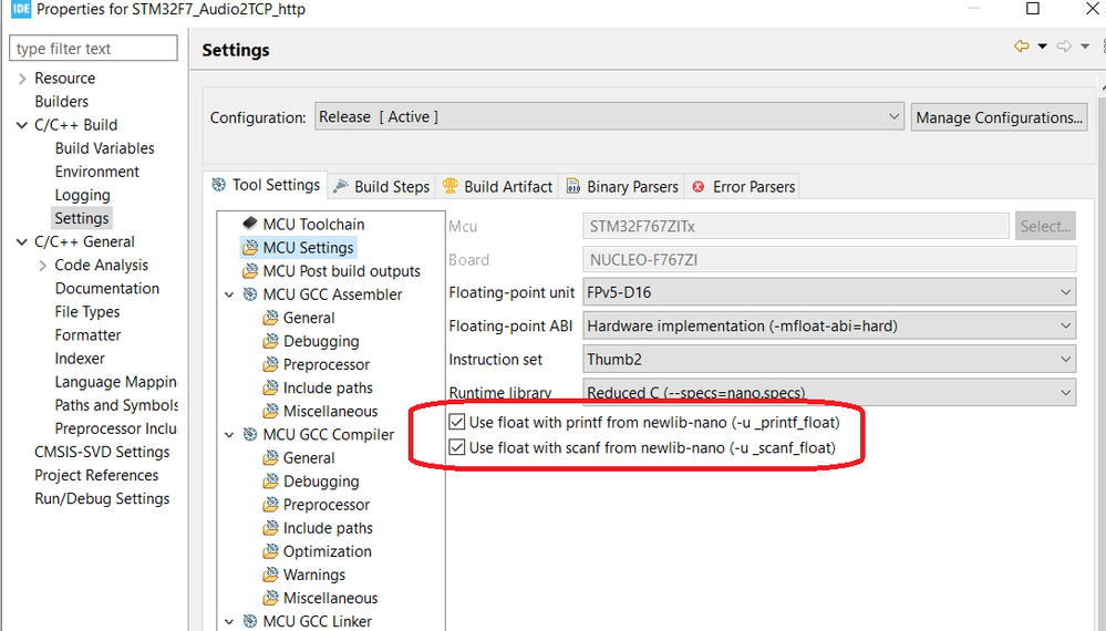

Second, maybe you need to set these checkboxes in the project settings:

Thanks,I have this done in my code still I am facing the same issue.
