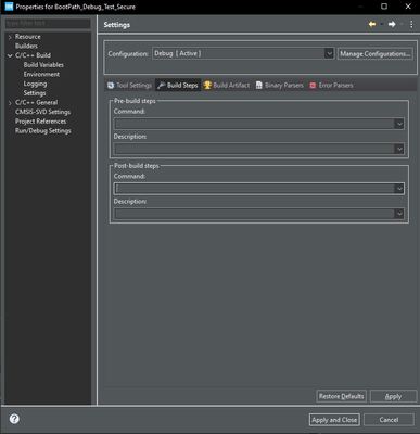

ARM provide an utility to merge hex files you can check it from ARM web site.
If you could run this command line successfully, you can make an automatic generation by adding it to the build configuration : Post build command.
