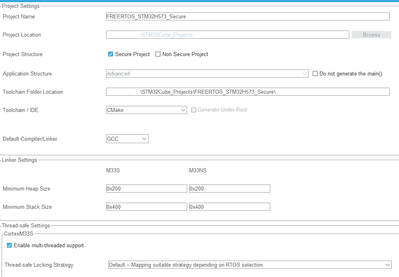

I have an issue with STM32CubeMX 6.17.0 (Windows 11 + Visual Studio Code)
I want to start a STiRoT Full secure project (with DA and encryption) for STM32H573 with FREERTOS.

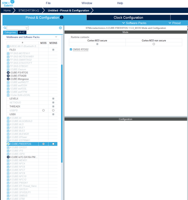

But when I add the freertos software pack, I don't get any configuration options.
If I add FREERTOS to non-secure I am able to open configuration options
I have added my IOC file.
Can someone tell me what I'm doing wrong?

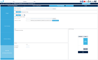

With DA and STiRoT. Why does the mapping for M33S start at 0xC000400 and not on 0xC0000000? Does this mean that my "Firmware Execution area offset" and "Firmware download area offset" can't both be 0x00100000 (1MB) but should be a little bit smaller? Or does the tool take that start offset into account?

After several attempts, STM32CubeMX always worked correctly, and I was able to enable
X-CUBE-FREERTOS in both the secure and non-secure contexts. This suggests that the shared .ioc file may have been corrupted.
Regarding the missing FreeRTOS configuration options in the secure context, the key point is that STM32CubeMX is mainly designed for the simpler TrustZone use model.
In this model, FreeRTOS tasks are typically created in the non-secure world, while the secure world provides protected services such as:
1- access to secure peripherals,
2- secure function calls,
3- or other trusted operations.
In a multitask environment managed by FreeRTOS, non-secure tasks may need to request services from the secure world. These interactions must be synchronized properly so that secure processing does not interfere with the expected real-time behavior of the system.
So, from a tooling perspective, CubeMX mainly supports this standard architecture, which is why the usual FreeRTOS task configuration is available on the non-secure side.
It is still technically possible to run an RTOS and create tasks in the secure world on a Cortex-M33 with TrustZone, but CubeMX does not provide full support or configuration UI for that advanced use case. If secure-side tasks are required, they generally need to be implemented manually by the user.
As a reference, you can check the example: FreeRTOS_Queues_ThreadFlags_TrustZone
This example illustrates the use of message queues, thread flags with CMSIS_RTOS2 API along with the use of FreeRTOS when the TrustZone feature is enabled (TZEN=1) readme
