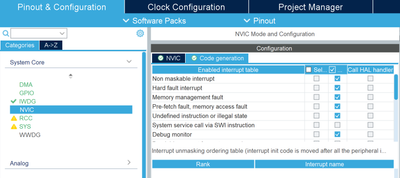

2023-07-04 8:39 AM - edited 2023-07-04 8:40 AM
Maybe here you can off on or simply exclude it file from build and use own.
