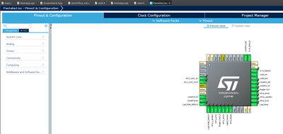

Sometimes it works, sometimes it doesn't.
When I try to open the IOC viewer either the IDE freezes or the view isn't rendered properly, as you can see below. This misbehavior breaks my working flow and makes me waste a lot of time. Any ideas?

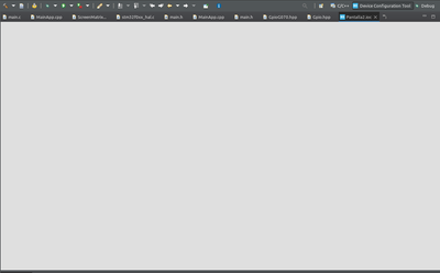

And ironically, today I haven't been able to use the IOC. It's been running for 20 minutes or so and it can't be rendered (100% CPU Java's usage):

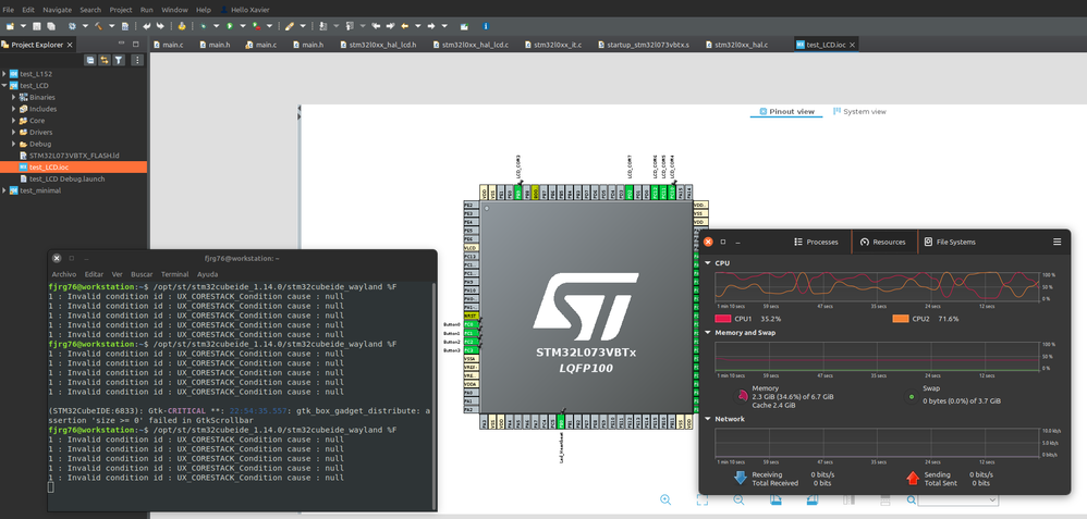

This is a plugin's problem: after deleting some of them the IOC renders. There are sometimes when the full IDE refuses to start at all, and deleting the same plugins solves it.
Later on I'll write a tutorial on this issue. Meanwhile, the IOC windows looks like this (after I've lost a lot of time, Thank you ST :(
