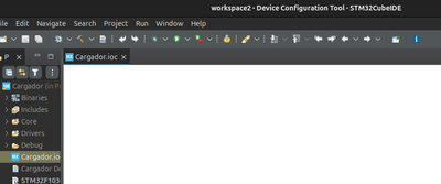

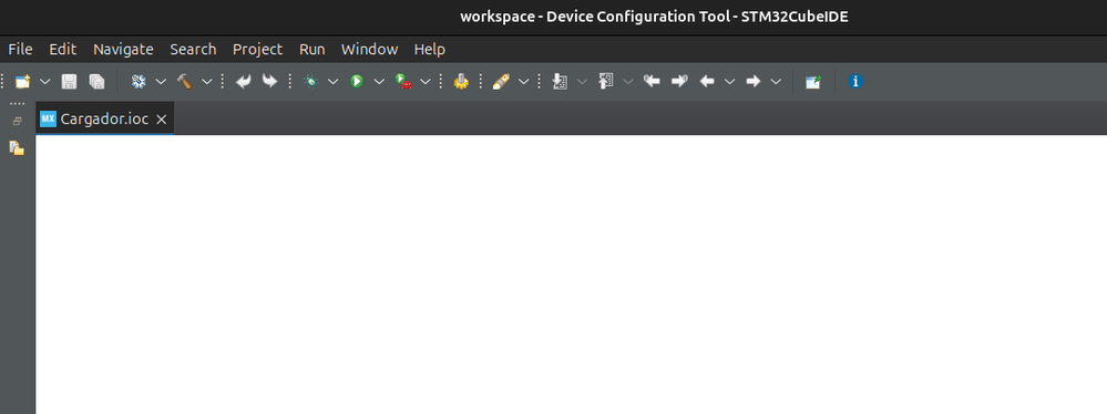

As of yesterday, since an update hit, my CubeMX view won't render (literally it is just a white background). Tried reinstalling and it renders, until I sign up and it updates again, then it stops rendering again. The rest of the IDE works just fine.
System:
Ubuntu 24.04.3 LTS (Linux 6.14.0-33-generic)
Dell Inspiron computer
8,0 GiB Memory
Wayland windows system
Gnome 46
CubeIDE 1.19.0

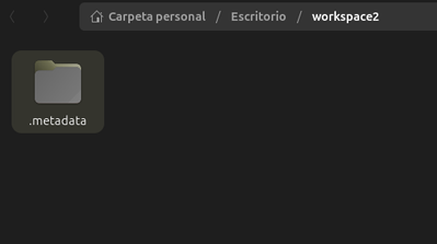

Let's try using a Fresh Workspace by following those steps :
- Start STM32CubeIDE.
- When prompted, select a new, empty workspace directory.
- Import your existing projects into the new workspace
If the Issue Persists: Clear the .metadata Folder
- Close STM32CubeIDE.
- Navigate to your current workspace directory.
- Delete the .metadata folder
- Restart STM32CubeIDE.
- Re-import your projects into the workspace.

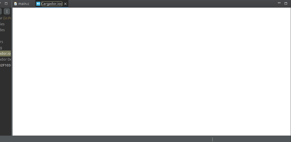

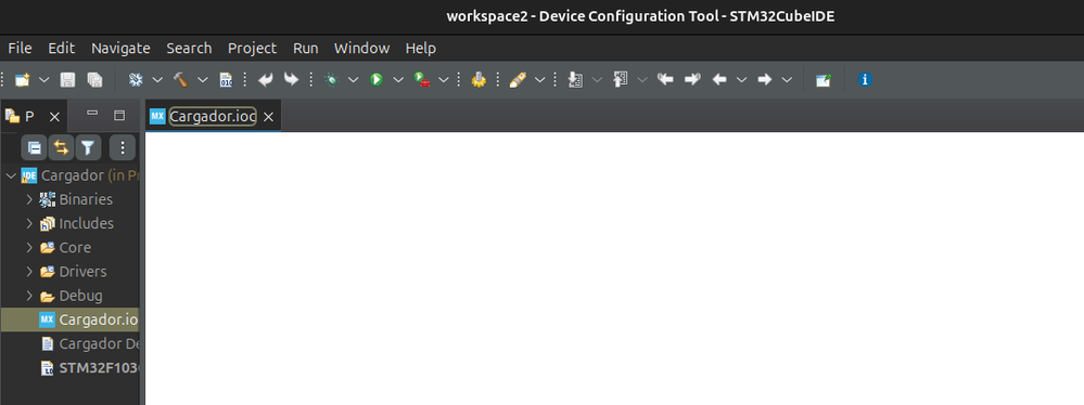

Done in order:
It didn't work. Even with new projects it doesn't work.

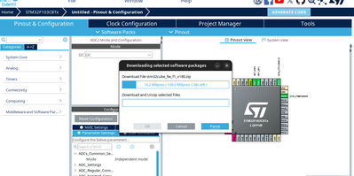

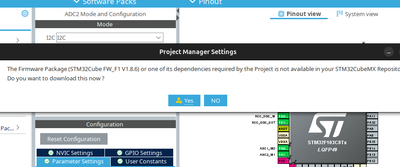

Same over there:
-I downloaded it
-Configured the chip -> "code generation requires packages, please log in"
-log in -> downloads updates and or packages
-tried to generate code -> app doesn't work anymore (freezed)
-close it -> open it -> tried to open the .ioc -> it doesn't open anymore
