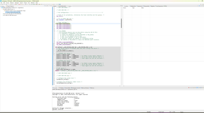

So i'm trying to do PD with the STM32N6, but i can't seem to be able to test the example code from ST. When i run USBPD_SNK, it just doesn't seem to work. I get a weird no source available issue. I thought it was because of ThreadX, but i tried VENC_USB and that example worked fine. The USBPD_SRC also fails to work.
I don't know if this a STMCubeIDE problem or something weird with the specific PD usb examples.

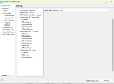

Hello @Brenden_PLUS
Please try to follow those steps:
Right click on the project -->properties--> C/C++ Build --> settings--MCU/MPU GCC compiler -->Debugging
and make sure that Debug level is -g3 as shown below
Apply and close . After that rebuild your project and start your debug session
THX
Ghofrane

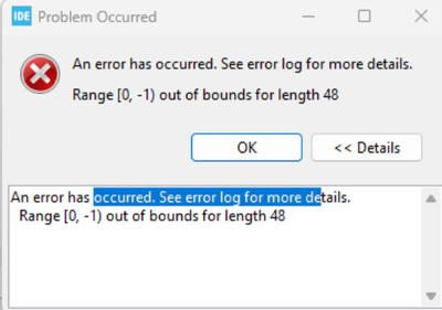

2025-11-03 11:43 PM
Hello @Brenden_PLUS
Did you encounter an error similar to the one below during debugging?
THX
Ghofrane
2025-11-04 2:45 AM - edited 2025-11-04 4:03 AM
It seems we have two different errors. The code
* compiles
* but fails at finding the start of the program
* I can continue the program and let it run, but it won't hit break points or ever figure out where the code is if i pause the code.
Error
On my computer i get this error that it can't find source file.
* No source available at "main() at 0x3418775c"
This happens on both
* windows
* linux
2025-11-04 7:04 AM
Hello @Brenden_PLUS
THX
Ghofrane
2025-11-04 8:34 AM
Thanks!
It looks like both the
* USBPD_SNK
* USBPD_SRC
only had release build. Thank you.
