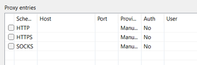

2024-09-27 5:46 AM - edited 2024-09-27 5:47 AM
I dont see Native option in proxy entry:
