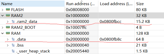

The optimization options for GCC compilation are: Optimize for size(-Os),The compiled result is as follows:
The size of MCU Flash resources occupied is: text+data = 47264 Byte
The.ld link script is shown below:

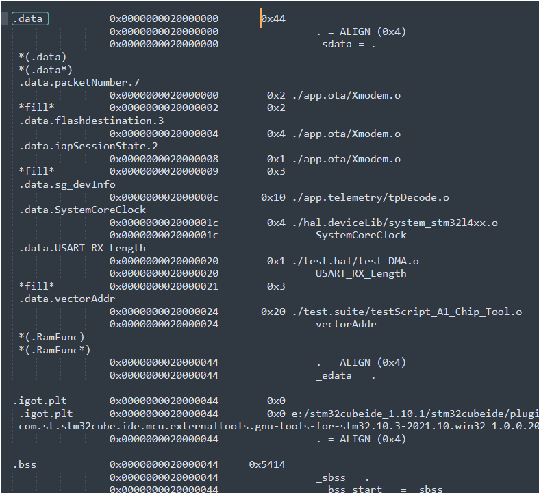

Question: In my program, the.data segment data (initialized variable) can not be 15K, in theory only 0x44 bytes size, this can be seen from the map file, as shown below:
I compiled the same project program using Keil and everything worked fine. What is the problem with me, or the GCC compiler?

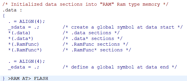

Below is the complete linked script file.

2022-09-27 1:52 AM
I have just modified the link script, the NOLOAD keyword was added,as follows:
.ram2_data (NOLOAD):
. = ALIGN(4);
_sram2 = .;
*(.ram2_data)
*(.ram2_data*)
. = ALIGN(4);
_eram2 = .;
} >RAM2 AT> FLASH
.ram2_boot (NOLOAD):
. = ALIGN(4);
_sram2_boot = .;
*(.ram2_boot)
*(.ram2_boot*)
. = ALIGN(4);
_eram2_boot = .;
} >RAM2_BOOT AT> FLASHThe compiled result is as follows:
The compiled results are now almost identical to KEIL.
Thank you for your reply.

I forgot to mention that I defined a bunch of global variables into RAM2, about 15k in size, but I didn't initialize them, and they shouldn't be in the .data segment, they should be in the .bss segment. as shown below:
2022-09-27 1:03 AM
>RAM2 AT> FLASH means, they are both in RAM2 and in FLASH.
The attribute mechanism of gcc places those data unconditionally into a given section. The implicit magic of splitting to .data and .bss based on explicit initialization applies only to those variables which are not explicitnly assigned to a given section.
.ram2_datas says, size 15.2kB, does that ring a bell?
