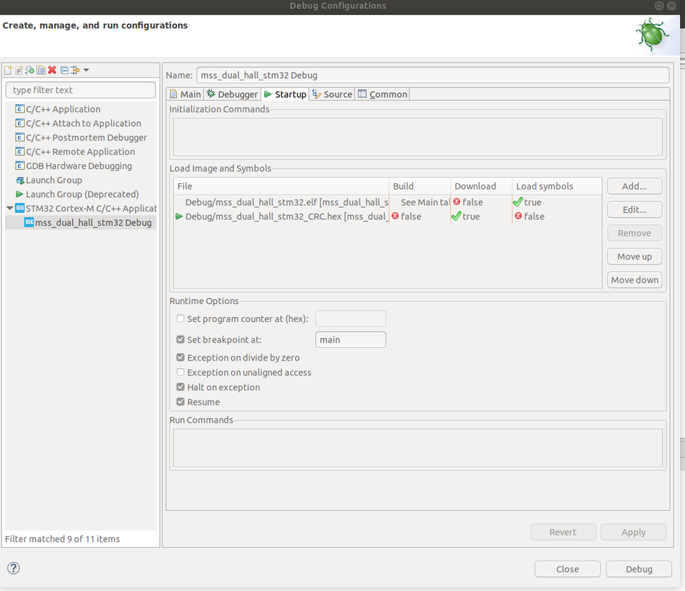

I want to specify the HEX file for data into the STM32 and the elf file for symbols used in the debugger. The User interfec has changed though and I seem to only be able to get one or the other (i.e. just the hex or just the elf).
This is a necessary operation as safety critical software need to be able to verify PROM contents
using a CRC32 generated off the target processor. Here is the modified 1.3.0 gui entry for the debugger
I can't see what's the problem with it. Yes it is supposed to flash the hex file, and consult the elf file for debugging symbols.
Do you perhaps mean that the hex file contains only the crc, and you'd rather want to flash both of them? In this case, enable generating a hex file from elf under Project / Properties / Settings / MCU Post build outputs, then concatenate the two hex files, dropping the last line (EOF marker) from the first one.

Does it happen when you load the hex file generated by CubeIDE post build options too?
2020-03-30 6:00 AM
AH Ok just tried this. Loaded symbols from elf and data from hex file. Worked as expected.
