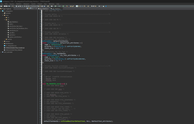

We have recently updated our STM32CubeIDE to a newer version (1.19.0, from 1.18.0) and we have encountered an issue when using CubeMX. Whenever we launch the code generation some code sections in the file 'app_freertos.c' get duplicated. For example:
/* Definitions for defaultTask */
osThreadId_t defaultTaskHandle;
const osThreadAttr_t defaultTask_attributes = {
.name = "defaultTask",
.priority = (osPriority_t) osPriorityNormal,
.stack_size = 1024 * 4
/* Definitions for i2c_Task */
osThreadId_t i2c_TaskHandle;
const osThreadAttr_t i2c_Task_attributes = {
.name = "i2c_Task",
.priority = (osPriority_t) osPriorityAboveNormal,
.stack_size = 512 * 4
};will become:
.name = "i2c_Task",
.name = "i2c_Task",
};and the same goes for the assignment of the task handles, as well as for the implementations of the task start functions. Other files like 'main.c' are not affected by this it seems. However I cannot confirm if the above mentioned file is the only one.

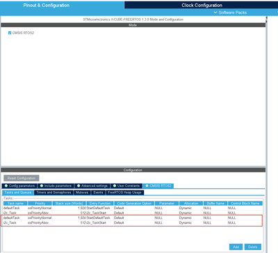

2025-07-17 5:12 AM
Hello @Katzenfutterdose ,
Further to your comment, I am not able to reproduce your behavior.
(Creating new Ioc.File with STM32U5G9J-DK2 on STM32CubeMX 6.14.0 and creating two tasks, then migrating the project to STM32CubeMX 6.15).
I suggest that you delete these two duplicate tasks, save the project and generate the code.
I will be waiting for your feedback.
Thanks.
Mahmoud

2025-07-17 5:28 AM
Hello @Mahmoud Ben Romdhane
Your suggestion fixed the issue. To be honest I didn't think to look at the FreeRTOS config inside of CubeMX as I didn't know it was possible to create two identical tasks in there. I still don't know how they got there in the first place but that doesn't matter now.
Thank you for your time!
