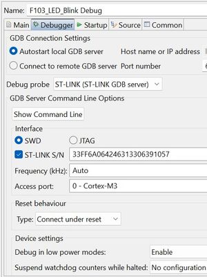

Could anyone advise how to setup STM32CudeIDE to debug my custom board using ST Link V2 ?

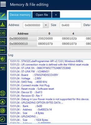

STMCube Programmer is working fine but not CubeIDE. Y ?

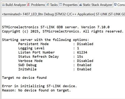

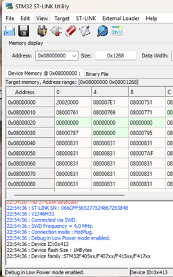

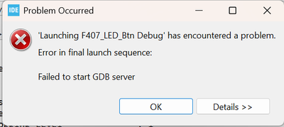

I try on the F407 DISCO board, same issue: can download the code but CubeIDE cant detect STlink V2, confirm SRLink V2 is fake! suck! the 2.9v isit an issue ?

test on STM32F407 DISCO
