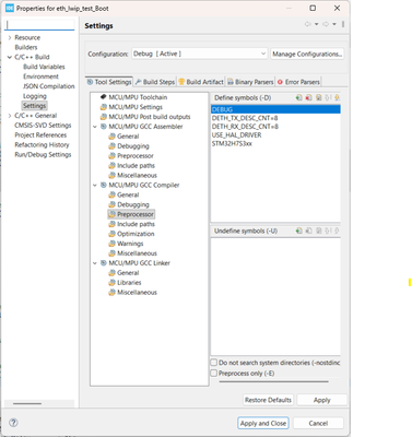

I did in compiler preprocessor (as shown in figure attached) and to check the value I am printing on UART in ethernet.c (in low_level_init() function )but it is unchanged.

I also tried to change in stm32h7rsxx_hal_conf.h but i always give me makefile error. I tried define again (overwrite), undefine and define again but I am not able to.

Remove the D. ETH_RX_DESC_CNT, not DETH_RX_DESC_CNT.
