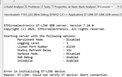

hi Andrew, yes can download on both STMCube Programmer and ST Link Utility but cant debug, error as below

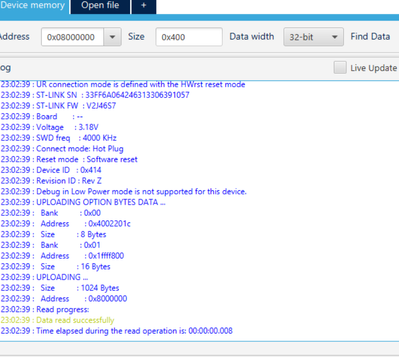

2025-10-09 7:59 AM
this too..
2025-10-09 8:03 AM - edited 2025-10-09 8:05 AM
Likely a fake/clone MCU - not a genuine STM32.
Try the diagnostic tool here:
PS:
Note that you get the same behaviour with Keil:
I guess, when it comes to debugging, it's more important to fully identify the chip than just for programming?
