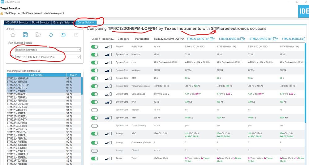

Cartu38 OpenDev
Lead III
Agree on @Peter BENSCH​  comments. Since former Atollic has been acquired by ST ... only ST's products are supported what sounds fair.
Would add you may have a way to enjoy STM32CubeIDE anyway ... let's rely on "Cross Selector" feature having a chance to move your current application to STM32 world ;)
File > New STM32 project ...
