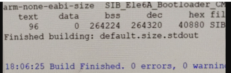

What strangely happens is that if I look to the size of the .text section at the end of compile process, it is equal to only 96Bytes which are a very small size infact my code doesn't work correctly both on debug and on release.

When I say that code doesn't work I mean that when I start the debug, program counter jumps to an invalid address (0xFFFFFF). This is an expected behavior because the flash memory is not written. If I look to the Memory address where the code should we loaded in fact I count only 96 bytes.

@zioMorgan wrote:
How to get a proper screenshot:
much better than a photograph of the screen!
Or just copy & paste it as text.
What optimisation setting are you using?
Maybe your code is all being optimised away?

This can mean that most of your code is not referred by main() and functions called from it, therefore the linker eliminates the unreferenced code. Check that your functions are actually called in the code.
Also this can happen if the linker cannot find the proper startup .s file or because a broken linker script.
