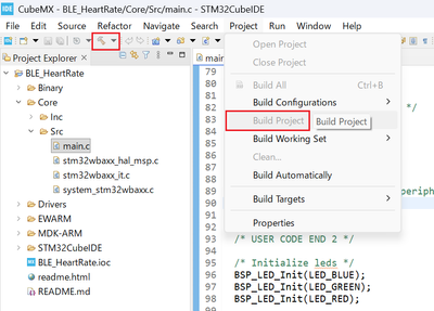

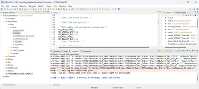

I was able to create a project in CubeMX and load it into the IDE, but I can't build it (the build button is not active).
Do you know the reason for this?
Hello @gocchan
Based on your comment and the screenshot you shared, it appears that you have imported the EWARM, MDK-ARM and STM32CubeIDE folders.
I recommend that you delete the [ BLE_HeartRate Example] and regenerate it with STM32CubeMX.
Thanks.

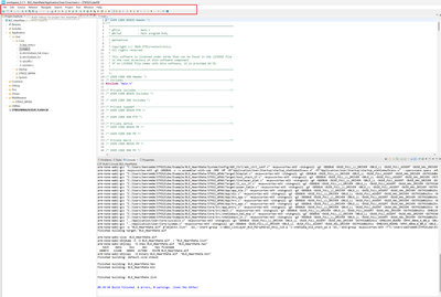

I tried generating a sample project from CubeMX again. I can now press the build button, but I don't know how to resolve the build errors.
The steps I took are as follows:

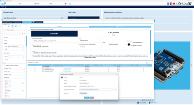

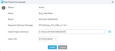

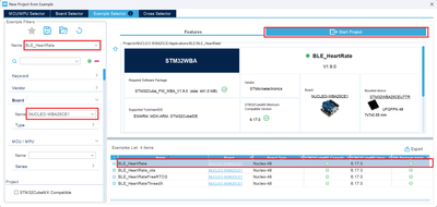

On the home screen, select ACCESS TO EXAMPLE SELECTOR, choose BLE_HeartRate/NUCLEO-WBA25CE1, and press Start Project.
Set Open with: to STM32CubeMX and press Install.

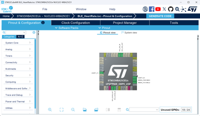

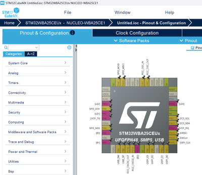

The Pinout view is displayed. At this point, LEDs 1-3 and Buttons 1-3 do not appear to be assigned (how can I assign them?).

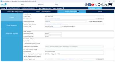

Set Toolchain/IDE to STM32CubeIDE and press GENERATE CODE.

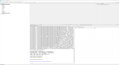

I can now press the build button, but I'm getting build errors.
Error message:
make: *** No rule to make target 'C:/Works/STM32/WBA25CE1/BLE_HeartRate/Drivers/STM32WBAxx_HAL_Driver/Src/stm32wbaxx_ll_dma.c', needed by 'Drivers/STM32WBAxx_HAL_Driver/stm32wbaxx_ll_dma.o'. Stop.
make: *** Waiting for unfinished jobs....

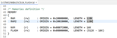

I tried one of the solutions suggested in the ticket, setting the RAM size in the linker script to 128K, but the build error persisted. The flag (-z noexecstack) is also set.
The build error seems to indicate that some necessary source files are missing, so I think the other ticket is important. Has CDM0060308 been resolved?

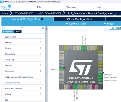

I was able to build the project by selecting BLE_Beacon and NUCLEO-WBA25CE1 in the CubeMX Example Selector.
However, I still get the same build error with BLE_HeartRate.
If I select NUCLEO-WBA25CE1 using the Board Selector instead of the Example Selector, a .ioc file will be generated that reflects the LEDs and buttons on the board.
However, the .ioc files generated by Example Selector do not seem to have these features.
How can I apply the pin assignments of the NUCLEO-WBA25CE1 to BLE_HeartRate and BLE_Beacon?
