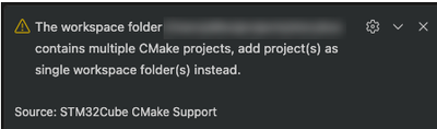

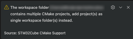

I suppose what I am reacting to is: I can open my workspace in VScode (which, yes, allows me to view multiple stm32 "projects" in the same tree, which is what I want), but then I see this popup:
In this state, the CMake extension icon on the left side of the VSCode window is not visible, and it is not clear to me how/if I can configure things to allow me to work/focus on a specific STM32 project, for building. Is this possible? If so, how do I do this?

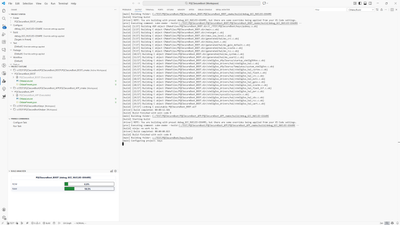

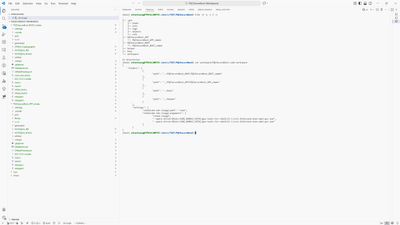

As you can see from the picture below, there are two CMake projects (as well as a Git repository) in the root of the demonstrated project folder:
After launching VSCode from project.code-workspace (PQCSecureBoot.code-workspace) as shown above, I can see those two CMake projects (as well as some other two minor projects) in the workspace which is defined in project.code-workspace:

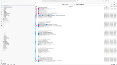

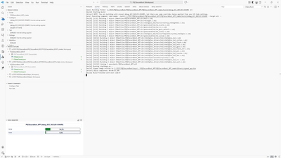

As you can see from the picture above, Git repository is also visible in the workspace. In the meantime, two CMake projects can be build correctly in CMake extension as shown below:
Are those what you're looking for?

This notification below is a guide to using a multi-root workspace, pointed out by @Cartu38 OpenDev
You are not forced (waning type notification) to do it, but if you do, it will help you the most.
