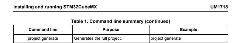

I'm not aware if STM32CubeIDE. Maybe you can rely on STM32CubeMX generating data setting STM32CubeIDE as outputs target.
Headless project creation is documented if STM32CubeMX. See user guide: https://www.st.com/resource/en/user_manual/dm00104712-stm32cubemx-for-stm32-configuration-and-initialization-c-code-generation-stmicroelectronics.pdf
