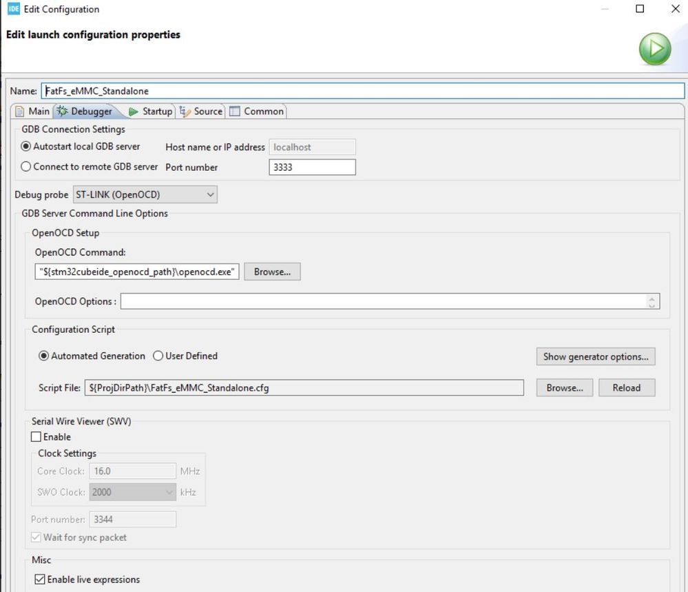

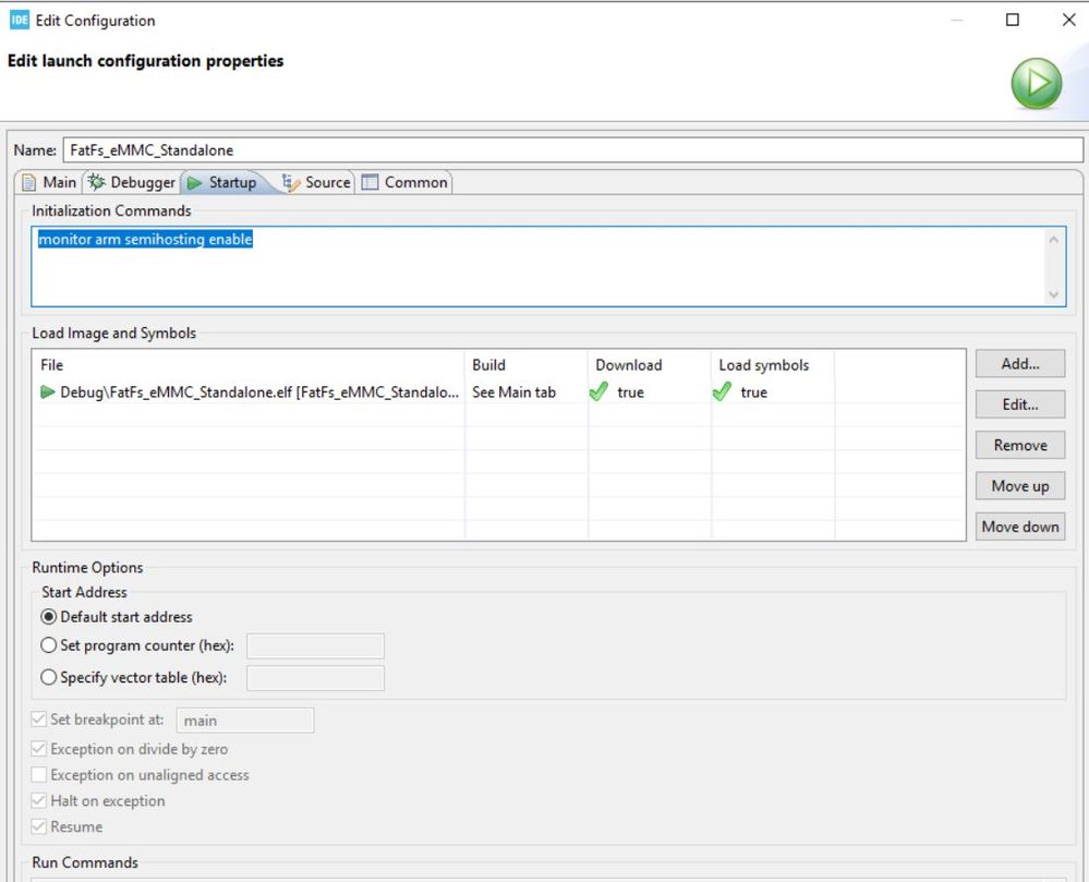

As workaround, I updated the Debug configuration in STM32CubeIDE as follow:
1- Use and configure ST-LINK (OpenOCD).
2- Add the command "monitor arm semihosting enable" into startup Initialization commands .

@Imen DAHMEN Thanks you, this was the work-around I got from a case I opened and it is a great work-around.
I look forward to an updated CubeIDE so that I may continue using GDB server.
