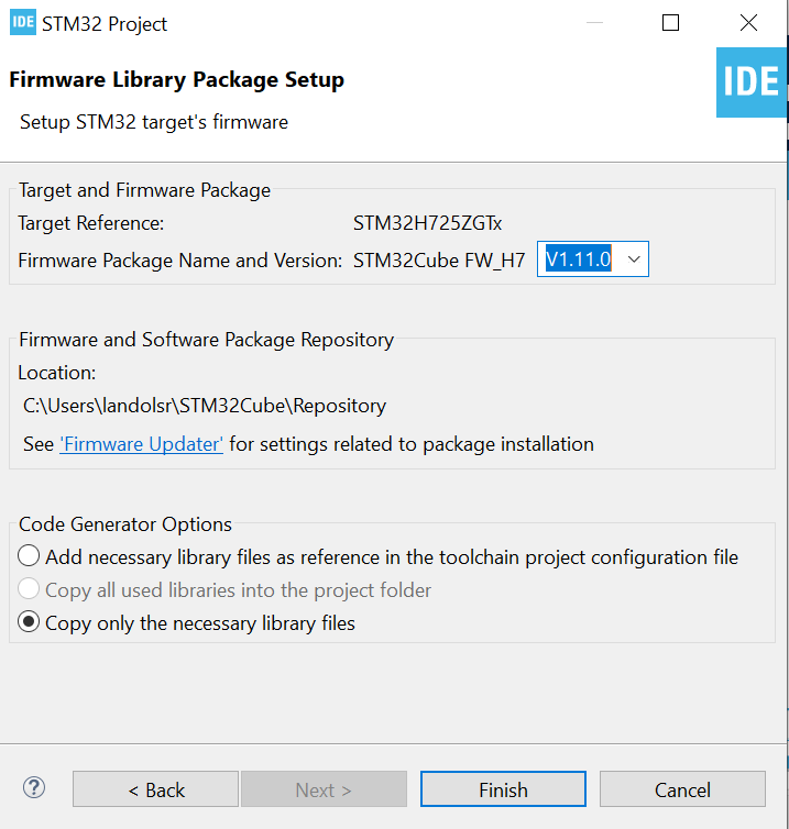

Hello @u1kano and welcome to the community,
If I understand correctly, the problem is that you are not sure that you are using the right FW package.
If this is the case, you just need to confirm when creating the project that you have used the correct firmware package name and version as shown in the screenshot.
Thanks,
Rim
