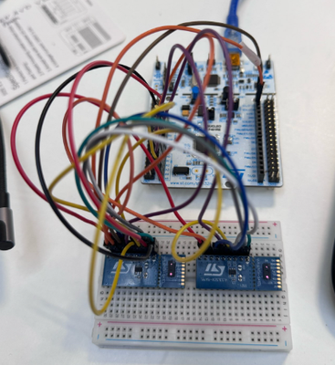

Please show a schematic of your setup - it's a far more effective way of communicating the setup than using words!
How are the VL53L5CX sensors mounted - a custom board? commercial breakout boards? other?
Some good, clear photos of your setup would help.

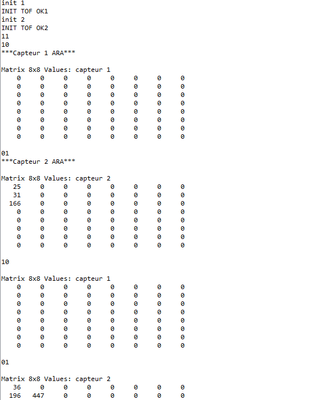

The issue is that both sensors operate individually on the same bus. I have initialized each sensor separately, and here is the output.
static void MX_VL53L5CX_SimpleRanging_Process_TOF1(void)
uint32_t Id;
    if(!activate)
printf("***Capteur 1 ARA*** \n");
    CUSTOM_RANGING_SENSOR_ReadID(CUSTOM_VL53L5CX, &Id);
CUSTOM_RANGING_SENSOR_GetCapabilities(CUSTOM_VL53L5CX, &Cap);
Profile.RangingProfile = RS_PROFILE_8x8_CONTINUOUS;
Profile.TimingBudget = TIMING_BUDGET; /* 5 ms < TimingBudget < 100 ms */
Profile.Frequency = RANGING_FREQUENCY; /* Ranging frequency Hz (shall be consistent with TimingBudget value) */
Profile.EnableAmbient = 0; /* Enable: 1, Disable: 0 */
Profile.EnableSignal = 0; /* Enable: 1, Disable: 0 */
/* set the profile if different from default one */
CUSTOM_RANGING_SENSOR_ConfigProfile(CUSTOM_VL53L5CX, &Profile);
status = CUSTOM_RANGING_SENSOR_Start(CUSTOM_VL53L5CX, RS_MODE_BLOCKING_CONTINUOUS);
activate = true;
status = CUSTOM_RANGING_SENSOR_GetDistance(CUSTOM_VL53L5CX, &Result);
print_result(&Result);
HAL_Delay(POLLING_PERIOD);
static void MX_VL53L5CX_SimpleRanging_Process_TOF2(void)
uint32_t Id2;
    if(!activate2)
printf("***Capteur 2 ARA*** \n");
    CUSTOM_RANGING_SENSOR_ReadID(CUSTOM_VL53L5CX2, &Id2);
    CUSTOM_RANGING_SENSOR_GetCapabilities(CUSTOM_VL53L5CX2, &Cap2);
    Profile2.RangingProfile = RS_PROFILE_8x8_CONTINUOUS;
    Profile2.TimingBudget = TIMING_BUDGET; /* 5 ms < TimingBudget < 100 ms */
    Profile2.Frequency = RANGING_FREQUENCY; /* Ranging frequency Hz (shall be consistent with TimingBudget value) */
    Profile2.EnableAmbient = 0; /* Enable: 1, Disable: 0 */
    Profile2.EnableSignal = 0; /* Enable: 1, Disable: 0 */
    CUSTOM_RANGING_SENSOR_ConfigProfile(CUSTOM_VL53L5CX2, &Profile2);
    status = CUSTOM_RANGING_SENSOR_Start(CUSTOM_VL53L5CX2, RS_MODE_BLOCKING_CONTINUOUS);
    activate2 = true;
    status = CUSTOM_RANGING_SENSOR_GetDistance(CUSTOM_VL53L5CX2, &Result2);
    print_result2(&Result2);
