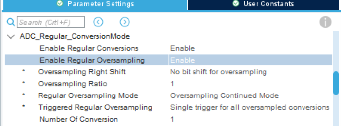

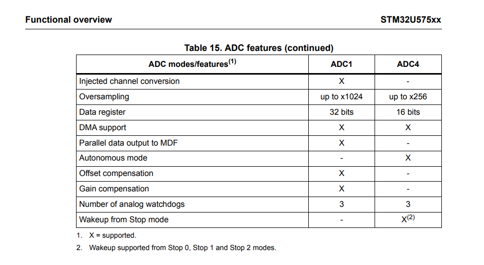

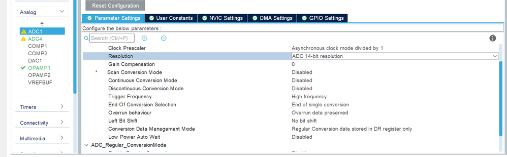

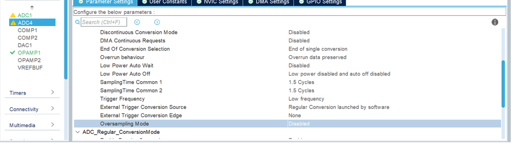

I think it does, but the Enable control is in the ADC_Regular_ConversionMode parameter group, just below :
