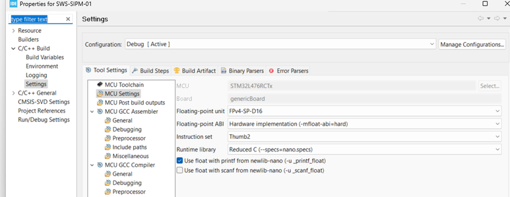

stdout (what you redirect) is normally line buffered. So nothing shows up until you send a "\n" or maybe some "\r\n" depending on your terminal settings.
Keep also in mind, that floating point output will not work unless you enable it in the project settings (STM32CubeIDE) or set appropriate linker options explicitely.

Did what you suggested... Still not working??? I notice when I break on a printf and try to step INTO the code steps OVER?? wierd.....

Solved..... \r\n NOT /r/n
