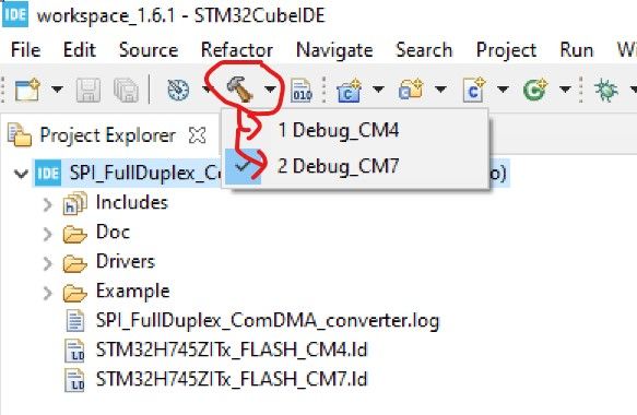

The example given in STMCUBEMX its support keil,ARM .I have to run that example on STMCUBEIDE someone tell me how I can run the example on CUBEIDE.
2021-07-18 11:16 PM
@MDeva.1 such is expected according to me.
To compile CM4 or CM7 part you have to move from one build configuration to another.
Such example project is not a STM32CubeIDE native one but a SW4STM32 legacy one STM32CubeIDE is able to import. Way to support such multi cpu devices like H7 is not exactly the same then.

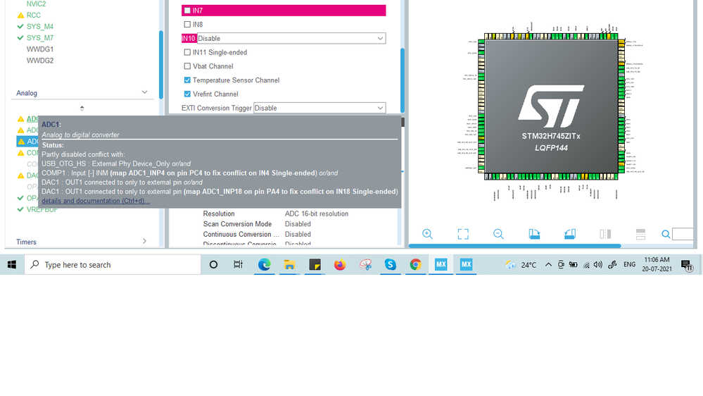

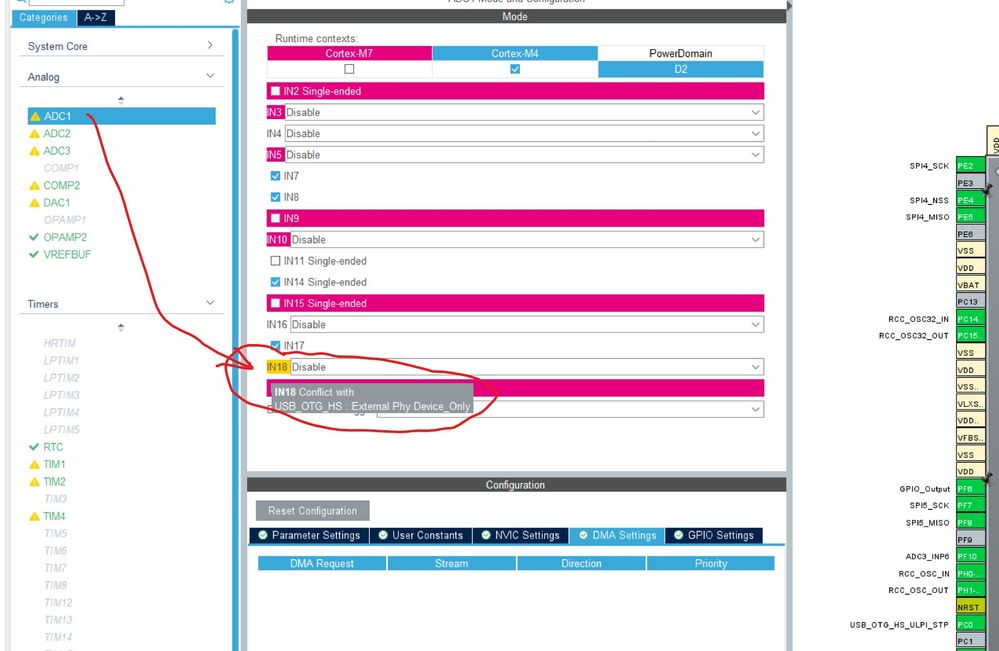

I need your help, I am working on the stm32h745zitx controller. My requirement is as follows:
1.USB_HS
2.USB_FS
3.Booting USART ,I2c
4.JTAG ,SWD
5.Total 6 spi=SPI 1-2-3 configure as Receiver only master at 75MHz, SPI 4-5 as Receive only master 50 MHz and SPI 6 as receiver only slave
6.10 ADC
7.3 timer
8.14 NSS external software pin
9.DAC
10.OPAM
According number this are my priorities but when I initialize the peripherals on peripherals yellow sign is shows. I want to ask that the what is yellow sign means? And the peripherals that I initialized are properly get initialized I am attaching the my the project file please tell me that initialized its properly.
Can you please help ,the initialization that i done is properly what is impact of yellow sign on peripherals can you explain me please.
2021-07-20 6:59 AM
Each warning should have an explanation ...
