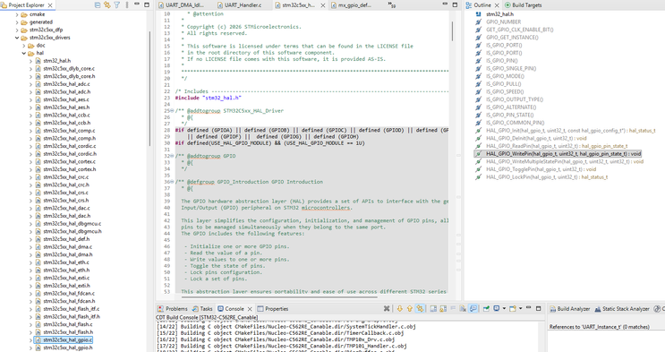

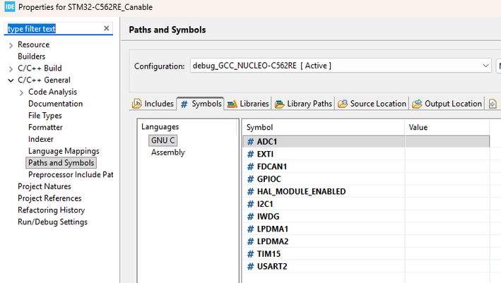

It could be the GPIO driver is not enabled. I've ran into the same problem.
I would check to see if the stm32c5xx_hal_gpio.c file is grayed out (not enabled).
I'm not sure if CubeMX2 is supposed to add defines/symbols automatically or if it's a bug, but I have to enable each peripheral even though i enabled them in CubeMX2.
For instance, stm32c5xx_hal_gpio.c HAL driver, it's all grayed out. The right column shows all the functions have a slash.
When I add "GPIOC" which is a one of the symbols, it enables the whole file. I have to add symbols for other peripherals as well.
You can see it's not grayed out and in the right column, the slashes are gone.

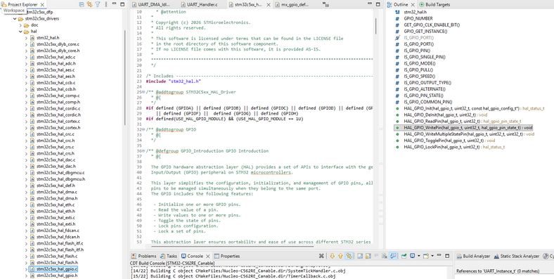

Autocomplete is clearly working in your screenshot.
What function are you looking for?
