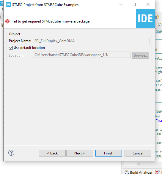

I am using the version of stmcubeide 1.5.1 and the error pic is attched
2021-07-13 7:01 AM
The STM32CubeIDE v 1.5.1 only supports the STM32CubeH7 MCU package v1.8.0 (old release).
So, you should update and use the latest release of STM32CubeIDE (v 1.6.0 ) with the STM32CubeH7 (v 1.9.0)

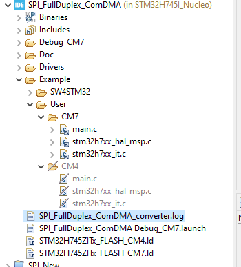

Sorry for late replying. I update the version of stmcubeide.But when project is open CM4 files are not opened. On CM4 cross marking is showing. So only CM7 .elf is getting.
