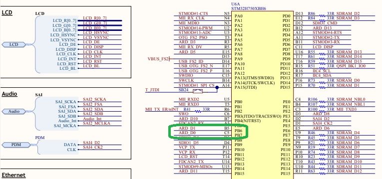

Show me this on the MB1381-B schematic for the H745I / H750I DISCO board..
Not associated with SCREEN/DISPLAY, only DCMI
LCD_VSYNC is PI9
Are you sure you're using the right board template?
@STTwo-32 This schematic is unhelpful, the ARD_D0/ARD_D1 connect to PB7 / PB6 USART1 / LPUART1

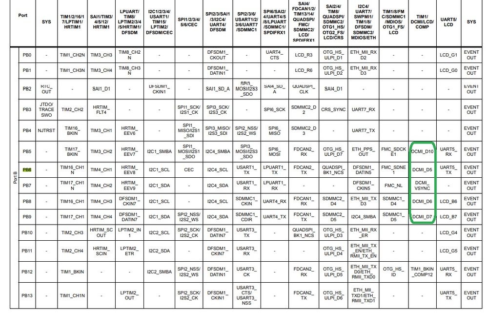

2024-10-05 4:36 PM
Doesn't PB6/PB7 clash with the CAMERA (DCMI) not the DISPLAY

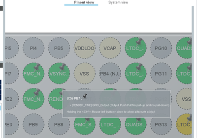

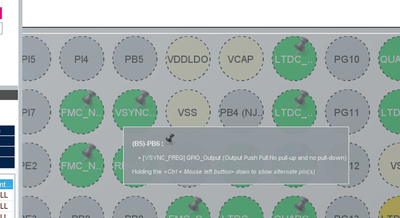

Hello Tesla DeLorean
STM32Cubeide indicates the following:
and if I am not mistaken in PB6 named B5 in the schematic it says that it is connected to a pin of the LCD.
LCD_VSYNC is PI9
2024-10-05 6:14 PM - edited 2024-10-06 12:22 AM
https://www.st.com/resource/en/datasheet/stm32h750xb.pdf
Show more of your screen so we can understand the CONTEXT CubeIDE is working with, that the board and the part selection are internally consistent.
ST could have messed things up, but this is for DCMI, and the H750B-DK (w/STM32H750XB) doesn't have a camera interface connection.

2024-10-05 6:27 PM - edited 2024-10-06 12:26 AM
See post above for H750XB Data Sheet, I clipped from the H745 Data Sheet that I had to hand, it's the same IC, but with all the flash memory tested.

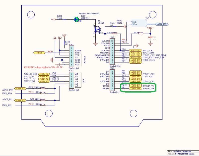

The schematic is the one you cited, I'm not sure the board has different revisions, but the NETS for the ARD_D0/D1 go to PB7/PB6
USART3 PB11/PB10 connects to the ST-LINK VCP

It is a new code which was generated from TouchGFX and I opened it in stm32cubeide just to start configuring the UART1 as I did in a clean code from stm32cubeide and realized that the pins were already assigned by defecot to something else.
TouchGFX ver 4.24.0 and stm32cubeide 1.16.0
I will then try simply deleting what those pins were used for by default and assign them to my USART1 to see if it works.
2024-10-06 7:52 AM
Many thanks to all of you, especially to Tesla DeLorean for the help. I finally moved those pins just in case by using ctrl+left click and dragging that pin.
(PB7 to PB8)
(PB6 to PA4)
and it seems to communicate TX and RX fine and no problems on the display.
