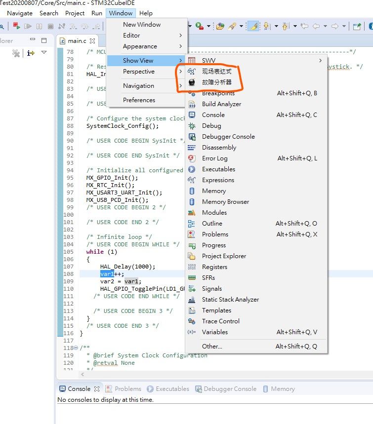

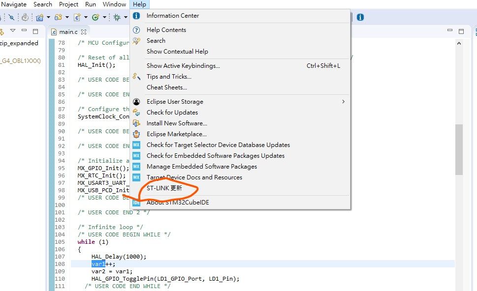

I just installed cubeIDE for a moment.
However, some text is displayed in Chinese such as follow,
Does anyone know how to change it to english text?

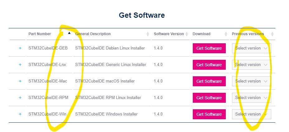

reinstall may be solved problem (select english version) while downloading

2020-08-16 10:41 PM
No, there are no selection for english version.
It just have to choice your OS and software version.

Yes, I tried. It's same.
I guess it may that cubeIDE will detect user OS information such like region or language setting.
My OS is WIN10, region is Taiwan with Tradition Chinese language setting.
It may be the reason, but I think cubeIDE should have optional setting for this.
