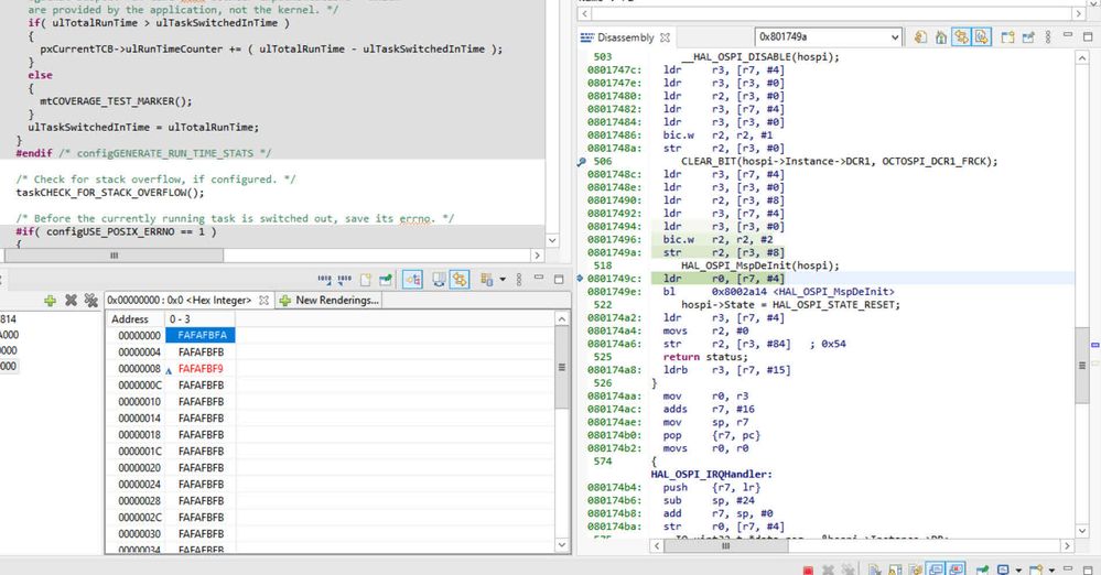

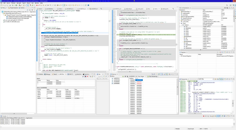

0693W00000GXSBWQA5.jpg0693W00000GXSBPQA5.jpg0693W00000GXSBRQA5.jpg0693W00000GXSBHQA5.jpg0693W00000GXSBCQA5.jpgHi Jan
Thanks for your prompt response.

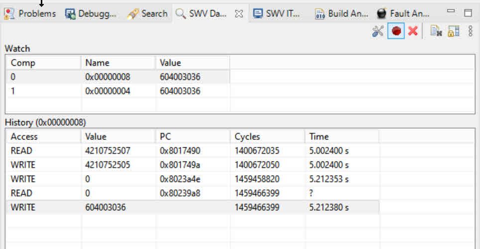

I took your advice and set up a couple of trace points at memory addresses 0x8 and 0x4.
Instead of running the functions in ITCM I left them in flash and put a pattern of 0x40 words in the ITCM starting at zero. (0xFAFAFBFB)
I then ran without break points and found that there were writes being made to the ITCM ram.
The first write was made by the ospi deinit:
The second by freeRTOS vTaskSwitchContext function:

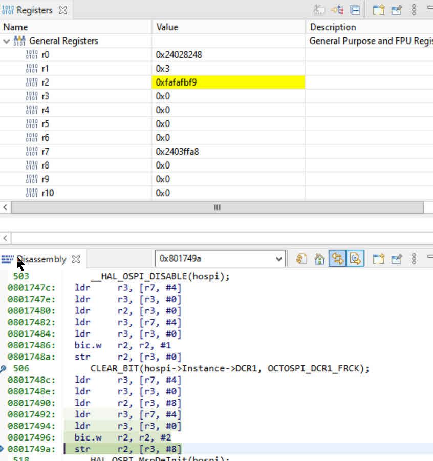

Looking at the disassembly first of these the, ospi de init we get:
You can see that the next instruction:
0801749a:  str    r2, [r3, #8]
will set the ITCM ram addr. to 0xFAFAFBF9
Which it does:
This looks a lot like a naughty stack problem. What do you think?

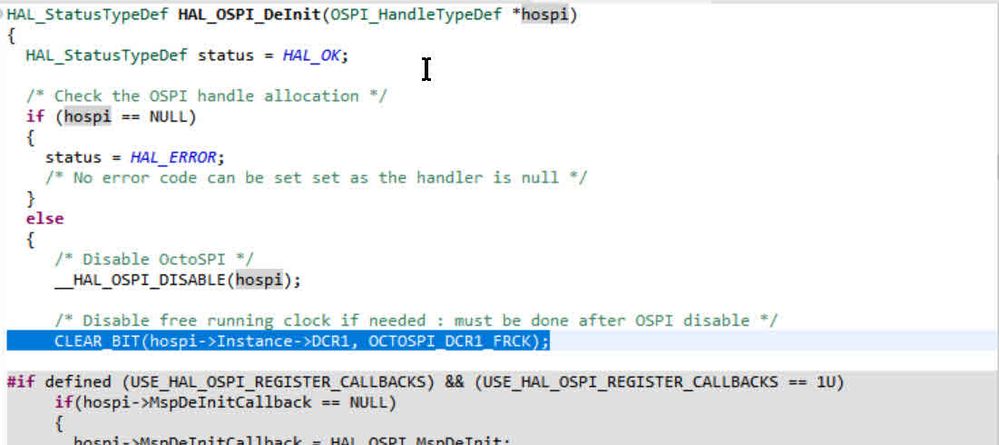

if (HAL_OSPI_DeInit(&hospi_nor[Instance]) != HAL_OK) this calls macro
CLEAR_BIT(hospi->Instance->DCR1, OCTOSPI_DCR1_FRCK); Line 17 below.
HAL_StatusTypeDef HAL_OSPI_DeInit(OSPI_HandleTypeDef *hospi)
  HAL_StatusTypeDef status = HAL_OK;
  /* Check the OSPI handle allocation */
  if (hospi == NULL)
    status = HAL_ERROR;
    /* No error code can be set set as the handler is null */
  else
     /* Disable OctoSPI */
     __HAL_OSPI_DISABLE(hospi);
     /* Disable free running clock if needed : must be done after OSPI disable */
as hospi_nor isn't initialized the clear bit macro accesses the ITCM address at offset #4.
I don't know what the programmer was trying to achieve and I didn't want to break working? code so I added the line:
  hospi_nor->Instance = hospi1.Instance;  /* rjg mod */
This sets the hospi_nor.Instance to the correct peripheral address.

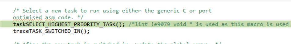

The second area overwriting was the uxListRemove function of the FreeRTOS lists module.
UBaseType_t uxListRemove( ListItem_t * const pxItemToRemove )
/* The list item knows which list it is in.  Obtain the list from the list
item. */
List_t * const pxList = pxItemToRemove->pxContainer;
	pxItemToRemove->pxNext->pxPrevious = pxItemToRemove->pxPrevious;
	pxItemToRemove->pxPrevious->pxNext = pxItemToRemove->pxNext;
Lines 7 and 8 were the lead in the saddlebags here. The cause was twofold first I had executed a task suspend before starting the scheduler and secondly i used taskSuspend on a sw timer rather than timerStop. This causes the uxTaskRemove function to behave badly and corrupt the ITCM.
Fixing my two errors stopped the problem, but I could see the same thing happening again. To prevent writing to the ITCM ram program area I invoked the MPU after copying the code from flash to ram. I set the MPU for this ram to read only so if I inadvertently try to write to it I will get a memory fault which is a lot safer than if the program soldiers on with bad code in the ITCM.
