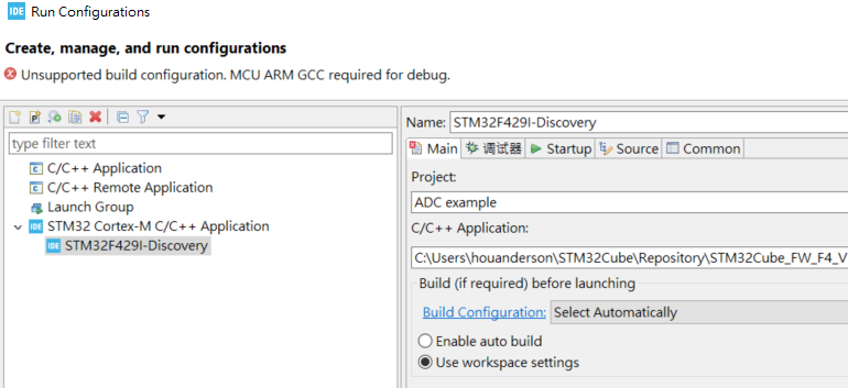

I'm a beginner of STM32. I get a STM32F429-Discovery and try to use STM32CubeIDE to start my journey. But I have a problem to import the example. I follow other people's question and import the example by "Projects from Folder or Archive. But in the Run configurations page I still can't start the running because "Unsupported build configuration. MCU ARM GCC required for debug". Do you know how to make it work?

2021-11-16 5:36 AM
To load an example, use the Example Selector.
File -> New -> STM32 Project -> Example Selector -> select your example -> Next -> Finish
2021-11-16 11:08 PM
Hi TDK
Thanks for your help. in the beginning it follow your step to get the example. It can't work and tool say " fail copy to the file". After I download a new STM32Cube_FW_F4 it work.
