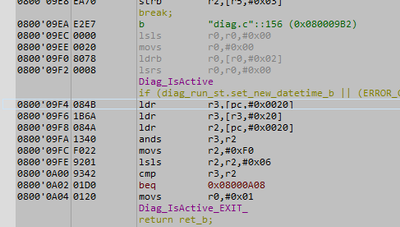

Now, I have show what is at this address for a function with the dissassamble:

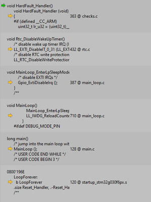

But the callstack from the MCU show me a other address:
I dosn't understand it at the moment, why is a 32bit ASM command is broken inside.
I use for the main loop only RAM functions, to becomes the needed performance. But the function Diag_IsActive() is placed into the flash. If this a problem?
