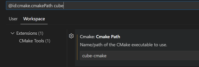

As a follow up, I noticed the folling are left behind in the settings.json file after an uninstall of all STM32CubeIDE extensions:
Perhaps the STM3CubeIDE extension should set this on a per project basis or something, so it doesn't mess up the CMake Tools extension.
But, this still does not resolve the problem. cmake is still called on the command line with -DCMKE_COMMAND=cube-cmake. It turns out that the stm extension also sneakily modifies the hidden settings.json file in your projects .vscode folder by adding:
