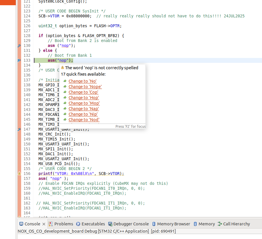

Manually setting SCB->VTOR = 0x08000000; at the top of main() resolves the issue and restores correct interrupt behavior.

I have a strong suspicion that your underlying problem is that for whichever reason, different address gets remapped to 0x0 than your application. It is possible that e.g. SysTick handler is being handled correctly, just not by the handler in your application, hence the application doesn't crash at first SysTick ISR. Most typical suspect is the "Boot from bank 2" BFB2 option bit. Please verify that your option bytes differ from factory values only in ways you intend.
If the change to the boot address is intentional, you can either do this by uncommenting the definition of #USER_VECT_TAB_ADDRESS in system_stm32g4xx.c (and potentially change its address too), or just rewrite the VTOR at the beginning of main().

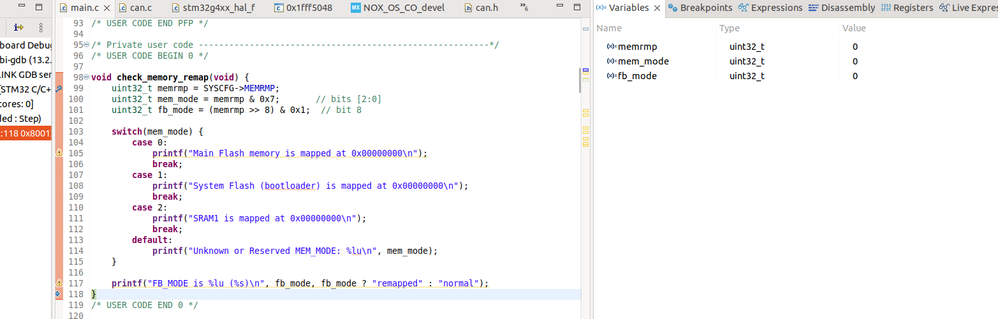

Can you please check the MEM_MODE and FB_MODE values in the SYSCFG_MEMRMP to see which part memory is being mapped to 0x0?

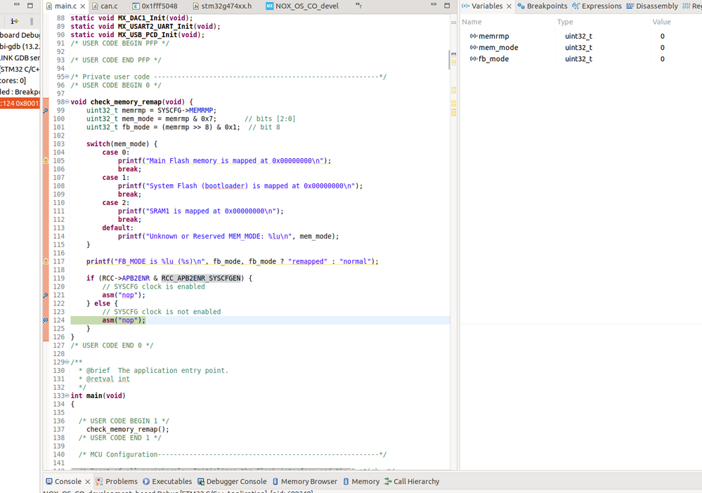

2025-07-24 7:40 AM - edited 2025-07-24 7:41 AM
Hope this is what you wanted. The function was called as first function in main (i.e. no HAL config calls yet)
2025-07-24 7:58 AM
That's pretty strange, MEM_MODE == 0 and FB_MODE == 0 should mean that main Flash memory at 0x08000000 should be mapped onto 0x00000000 and changing VTOR from 0x0 to 0x08000000 should make no difference.
Did you enable the clock for SYSCFG before reading it? That would be RCC_APB2ENR_SYSCFGEN. Without the clock, it would always read as zero.
If it actually contains zeroes (you can make sure by checking whether you're able to toggle the bits using the debugger), can you re-check that the problem exists when VTOR=0 and gets fixed when VTOR=0x08000000, and if yes, check whether you see the same or different memory content at memory 0x0 and 0x08000000?
2025-07-24 8:21 AM
Ok this does not appear to be configured. Where would I find this in cubeMX part of stm32ide?
