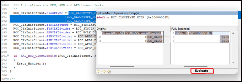

I am using STM32CubeIDE (eclipse) and was wondering if it is possible to get the constant calculated value of a macro.
For example
#define A 1
#define B 2
#define R A+B   // R is now 3
#if R > 2
  #warning R is greater
#else
  #warning R is less 2
#endif
I can only see 1+2 in the macroexpansion. But clearly the IDE has calculated the value and can evaluate the #if ... #else and gray out the unused part. So how can i access this calculated value?

Thanks for all the replies. I solved it by simply putting a little python script in the prebuild step that parses and calculates the values and displays them in the console. Would be nice though to have such a functionality build in. Case closed.

The Compiler Explorer could be useful for that - you can copy & paste the full macro expansion from the IDE into it.
