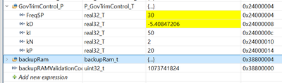

I have a functioning project that fully compiles with only three warnings, but when I debug it and examine C structures in the live expressions viewer the the data (GovTrimControl_P structure ) appears to be offset by 4 bytes, yet the memory browser shows the correct values and when the mouse hovers over a value that value is correct:

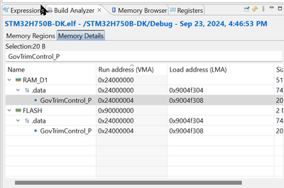

The Build Analyser also reports the address of GovTrimControl_P  correctly

The values for the GovTrimControl_P structure are set at bootup to:
/* Parameters (default storage) */
struct P_GovTrimControl_T_
  real32_T FreqSP;                     /* Variable: FreqSP */
  real32_T kD;                         /* Variable: kD */
  real32_T kI;                         /* Variable: kI */
  real32_T kN;                         /* Variable: kN */
  real32_T kP;                         /* Variable: kP */
typedef struct P_GovTrimControl_T_ P_GovTrimControl_T;
/* Block parameters (default storage) */
P_GovTrimControl_T GovTrimControl_P =
  50.0F,
  /* Variable: kD */
  2.0F,
  /* Variable: kI */
  20.0F,
  /* Variable: kN */
  2.0F,
  /* Variable: kP */
  30.0F

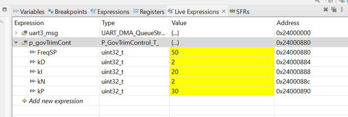

The problem also occurs with another constant array where the Live Expression viewer reports incorrect framing of the underlying data.

I have never seen this occur in any of my other similar projects with older versions of the IDE.
Has anyone else seen this problem

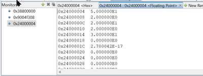

I made a very small project with the same data structure as GovTrimControl_P and the mis-framing did not occur.
I then thought maybe the data appeared misaligned to the IDE which only happens with a big project so I added __attribute__((__aligned__(4))) to my variables and voila it is fixed.

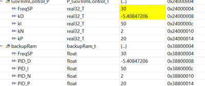

backupRam_t __attribute__((__aligned__(4))) __attribute__((section (".VBAT_SRAM"))) backupRam;
And
P_GovTrimControl_T __attribute__((__aligned__(4))) GovTrimControl_P =
  /* Variable: FreqSP
   * Referenced by: '<S1>/Constant'
  50.0F,...
Of course the data isn't misaligned as the data are floats, the IDE just thinks it is.
So there is a bug in the IDE, that only seems to appear in non-trivial projects.
Adding the alignment seems to work so All is Good.
The problem re-occured so it seems the attribute  aligned isn't the answer.

I tried your data structure on a Nucleo-G431KB and didn't see any issues after several debugging tries. The Live Expression looked good.
I then grabbed a STM32H750B-DK and copied over the code from the G431.
On the first debug, the FreqSP showed 30. Somewhat similar to what you show. Unfortunately i didn't get screen grab of it.
I then added an attribute to align the data structure and debugged again. The data looked normal.
I removed the attribute and I tried debugging at least 15 times. I can't seem to produce the same issue. Maybe it was just a random one time fluke?

My teammates also got that issue randomly with cubeIDE v1.16.1.
This bug is very random as we already had two laptop with the exact same code version and configuration with one getting this issue and not the other.
Today I got an issue with a memory offset of +8bits. Sometimes it is +32 bits...
