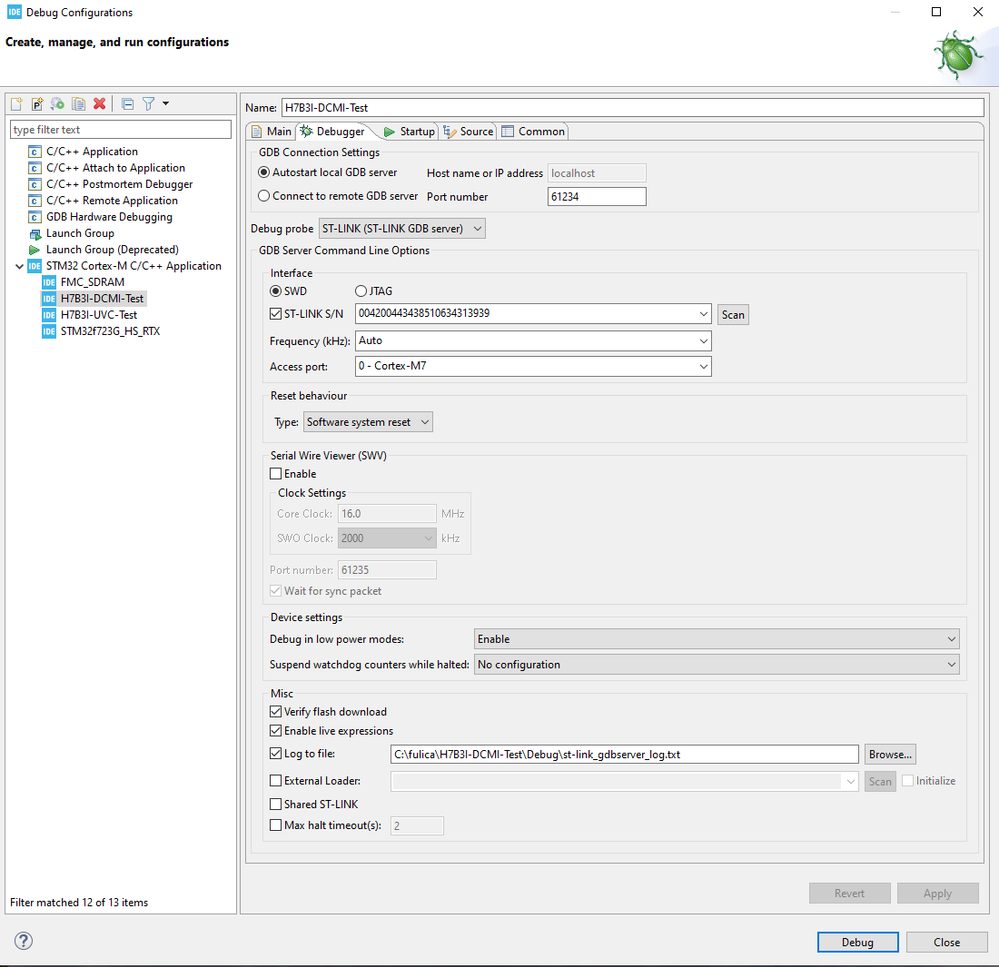

Do you have the stand-alone version of CubeProgrammer installed? If so, can you connect the board that way? It's available here.
I also noticed you have the log to file activated, do you get information about what happens (if anything) when you're trying to launch the debug session?

Yes, I activated log to file but log file was not created. So, I could not figure out what problem is there. STM32CubeIDE should create log file or notify what error is there.
Anyway, I installed CubeProgrammer and I can connect the board using CubeProgrammer. This is what I want actually. I need to program and debug using STM32CubeIDE.
What's next step? Can you do Webex or Zoom meeting to solve this issue?

I believe the next step for now is to see if I can recreate the issue. What OS are you running? And you're using CubeIDE 1.6.0 as in the title or have you updated to 1.6.1?
Do you have access to another computer to see if this fault shows up on both machines? What type of project is this? An STM32 project? Is there a difference if you create an empty project? (File -> New -> STM32 project -> Select board -> Next -> Select empty project).. It's the same screen where you name the project.

It looks problem was in my workspace. After I create new workspace, I can connect debugger and can download now.
I think you can close this issue.
