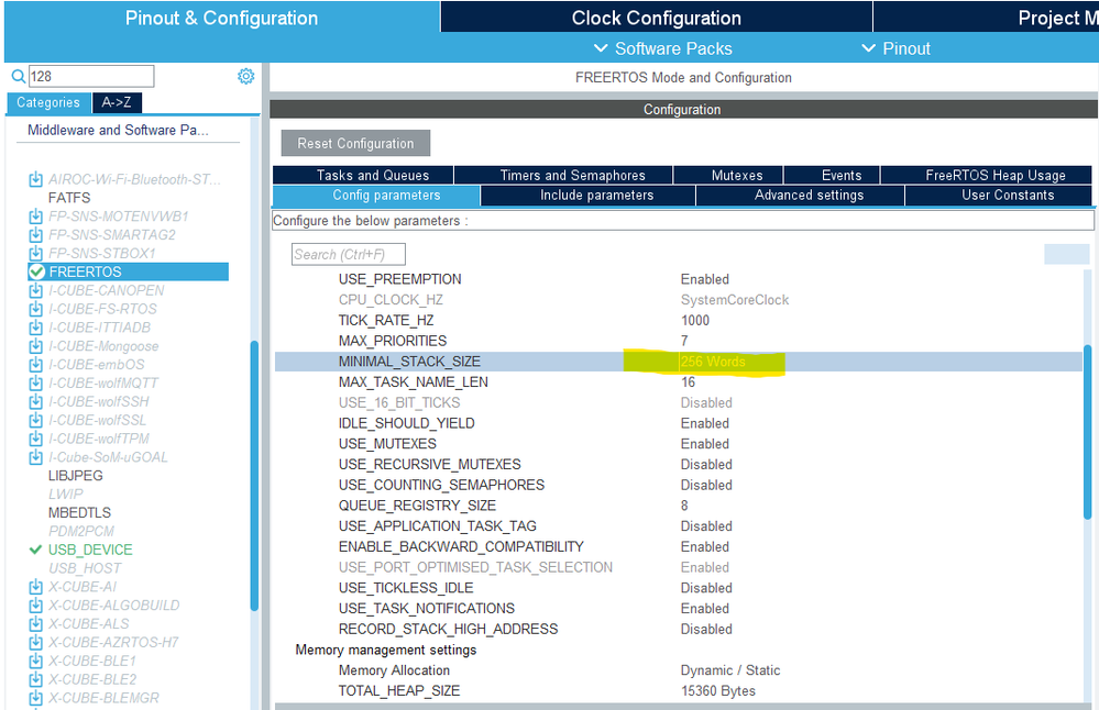

zmin
Associate
Increasing the MINIMA_STACK_SIZE can solve the problem.
FBL
Hi @RAbdu.1542
To address the issue you're facing, I recommend the following steps:
  1. Update CubeMX to latest version.
  2. Compare generated code from working and not working IOC file.
  3. This issue might be linked to CMSIS V1 as you may not increase the stack size for USB task.
Best regards,
