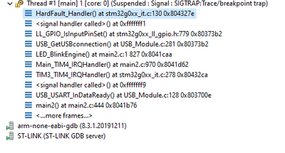

I'm trying to find the cause of a hard fault in my code. The problem repeatedly appears after a few or more minutes after starting the code, sometimes not at all, sometimes every time at close startup after enabling interrupts, and somethimes after a few seconds, as if it were dependent on the compilation. Somethimes watchdog re-runs code.
CubeIDE, STM32G0
I tried debugger IDE and here apears something like this:
What does mean signal handler FFFFFFF1 and FFFFFF9 ? Maybe it helps me to find the problem.
I dont use freertos, I dont use dynamic memory allocations. Only interrupts with 4 priority levels

Have a look at the Programming manual for your stm32 to find out about the 0xfffffff1 type of LR values.
In the section"Exception entry and return" it tells you that a special value with bits[31:4] 0xfffffff indicates a return from exception which involves things like changing processor-mode and using a different stack pointer.

My suspicion is that your USB_GetUSBConnection() wants to know the state of a pin, calling LL_GPIO_IsInputPinSet, but the pin definition is bad, not yet set up, or corrupt.
2024-05-21 3:05 AM - edited 2024-05-21 3:22 AM
Thanks.
After recompile i get hardfault each time after 5 seconds program starts. But is is in debug mode.
This time i get 0xFFFFFF9 only
And here there is no pin access, only to variables.
When I compile release version program gos into hard fault handler almost after enable interrupts.
Very suspicious is interrupt handler, when I use 3 different usart interrupt handlers.

very strange
Inlcuding modules (that are not even called at all - I moved calls to them to section that are used only in special configuration) generates that hardfault after 5 seconds after startup.
When theese modules are excluded from compilled code, everything works ok.
It looks like a software problem. But stack trace when hardfault occures is useless.
