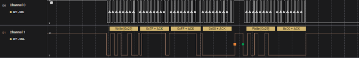

Here is what i get with the osciloscope:
The first part corresponds to the write and works correctly. The second part corresponds to the read function, but the address of the register should be a16 bit sequence, but i only get the first byte, then the I2C bus is stuck (sclk stays at 0V).

Your second transaction is a write, not a read. Sure that's the transaction that corresponds to HAL_FMPI2C_Mem_Read_DMA?
Does the non-DMA version work? HAL_FMPI2C_Mem_Read. If so, probably the DMA can't access the region where the memory is at. What's the address of tab?

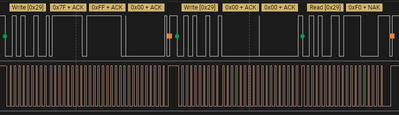

HAL_FMPI2C_Mem_Write(&hfmpi2c1, 0x52, 0x7fff, FMPI2C_MEMADD_SIZE_16BIT, tab, 1, 1000);
HAL_FMPI2C_Mem_Read(&hfmpi2c1, 0x52, 0x0, FMPI2C_MEMADD_SIZE_16BIT, tab, 1, 1000);gives:
2025-10-13 3:29 AM
And I don't think the problem is the address of the data for reception. The frame stops in the middle of the register address, so not yet on the read part.
