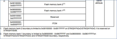

But i think it's not authorize because i read these comments is the reference manual :
So, i suppose it's not authorise to grow up the FLASH1 in my case. What is your opinion about his subject ?

This is what you have to take into account (From the datasheet Table 2). The flash size config depends on the device:
For the config 2 x 512k the flash is not contiguous. So you are limited to 512k for each bank and you cannot bond them. For the second case: 2 x 1M: you can use all the 2M without issue. The two "1M" are contiguous.

If you have 2x1M device, you can use all the flash so simply stretch the region Flash1. If it overlaps with Flash2 move it in the next contiguous address.
2024-02-26 12:59 AM
In my case i have 2x512KB (STM32H743ZGT6) so it's not contiguous. It's possible to use the FLASH2 with this device ?
2024-02-26 1:14 AM
It's not possible if the flash region you configured in linker file exceeds 512kB.
Already said:
"For the config 2 x 512k the flash is not contiguous. So you are limited to 512k for each bank and you cannot bond them."
