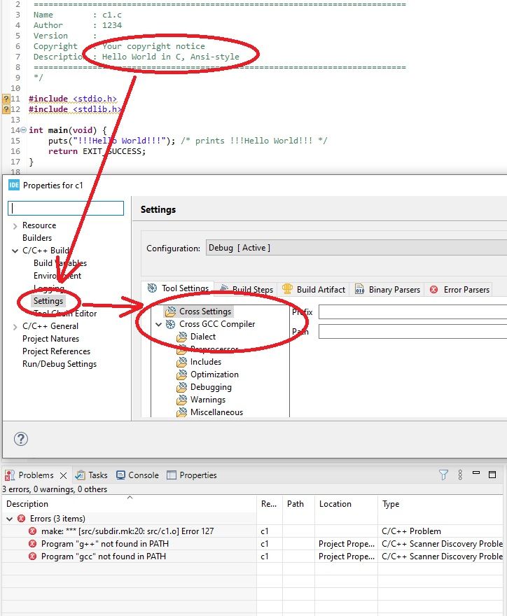

22:39:03 **** Incremental Build of configuration Debug for project c1 ****
make all
Building file: ../src/c1.c
Invoking: Cross GCC Compiler
gcc -O0 -g3 -Wall -c -fmessage-length=0 -MMD -MP -MF"src/c1.d" -MT"src/c1.o" -o "src/c1.o" "../src/c1.c"
c:/st/stm32cubeide_1.12.1/stm32cubeide/plugins/com.st.stm32cube.ide.mcu.externaltools.make.win32_2.0.200.202301161003/tools/bin/sh: gcc: not found
make: *** [src/subdir.mk:20: src/c1.o] Error 127
"make all" terminated with exit code 2. Build might be incomplete.
22:39:04 Build Failed. 1 errors, 0 warnings. (took 789ms)

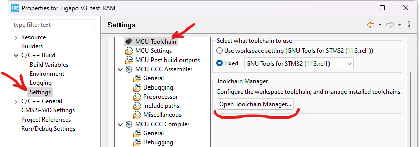

Just select the needed toolchain version in the CubeIDE project properties.
When CubeIDE runs build, it automatically adds the toolchain and make to the PATH.
There is no need to tinker with PATH manually.

But oooops... I can't find this item. Where is it?

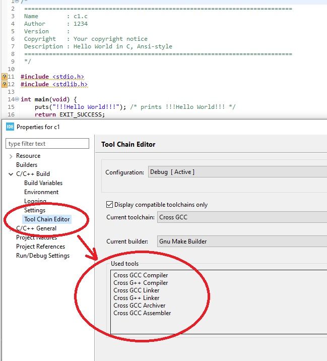

...The Tool Chain I have found also. And I don't know, does it need to be changed? :

There's no "Tool Chain Editor" in CubeIDE. If you don't have CubeIDE, you have some other toolchain, right? Then you know where you installed it.
If you have common Eclipse CDT with Embedded C/C++ add-on, here is the documentation: https://eclipse-embed-cdt.github.io/
no.
